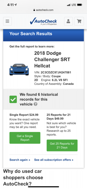

Buddy has a car in his shop represented as a Demon. Looks like one, but the VIN isn't pulling anything up which is strange.
Anyone got the juice on this to confirm if it's real or something fishy?
VIN: 2c3cdzc97jh247081

I'm not finding anything on this VIN either
47,792
Wow I just called my personal Service Tech at the dodge dealer and that vehicle is not matching the Chrysler Data base to the point the Chrysler has never produced this vin. And then to even add more mystery the last 8 of the VIN match to a SXT Charger. Wow this is a car that has been tampered with and how KBB got this vin is really disturbing. Meaning if this person purchased this car from someone telling them its a Demon they got screwed.

Ok....I did a search for Demon VIN decoder.
I found this posting from the old forum (I know...I know,,,but it was for science)
For example for VIN @#$& listed by RS we know almost the complete VIN number, 2C3CDZH9?JH10@#$&
2 = Canada made
C = Chrysler Corp
3 = Passenger car
C = active restraints with side and front airbags
D = Dodge
Z = 2 door
H = Demon model
9 = 6.2 l engine
? = checksum
J = year 2018
H = Brampton Plant
@#$& = VIN
Then I did a search for Demons for sale and found these, which seems to confirm that the "H" in the VIN is what shows that it's a Demon.
2C3CDZH90JH101890
2C3CDZH9XJH102075
2C3CDZH95JH102243
2C3CDZH93JH100023
2C3CDZH95JH100704
2C3CDZH92JH100109
So....based on the VIN you provided in your first post.....it looks like ...no....that car is not a Demon

We think its stolen. Original dash plaque 1366. It's got 2074 on it now. Maybe someone knows someone on this car?

Sorry not 1366. Looking like someone went to extremes to convert a Hellcat to a Demon.
