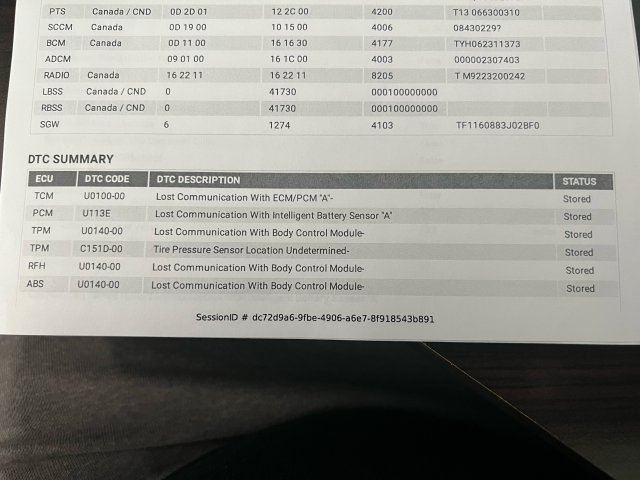

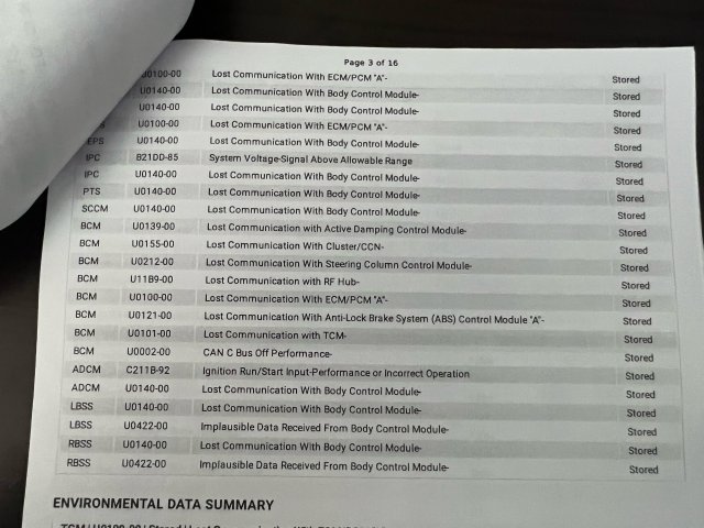

Got it into our service department yesterday hoping the battery would test bad and be causing the issues but the battery is fine. It spit out a TON of codes though, a lot relating to the BCM. codes1.jpg codes2.jpg
I am hoping it's just a bad BCM or loose electrical connectors at the BCM. I have the option to completely walk away from this car with no cost out of my pocket, and I am starting to consider that if it's not a simple fix. For some reason, electrical issues really get to me as I've seen cars with stuff like this not fully ever get resolved. I do still have my 2015 Hellcat as well so it's not like I would be without a Challenger. Investment-wise, I think having a last year Redeye would pay off in the long run, and I do love the car aside from these issues so I'm a bit torn.

Yeah it’s unique to this vehicle only. Seems like a lot of modules don’t want to talk to the BCM or vice versa with some PCM and TCM communication issues thrown in for good measure.

Rf hub/bcm needs to be replaced

That's almost every module on the canbus. I wonder if you have a bad canbus connector.
That’s my thoughts too. Especially with it displaying no bus on the cluster. Even more fun because it’s random.
Yeah, bad star port maybe?

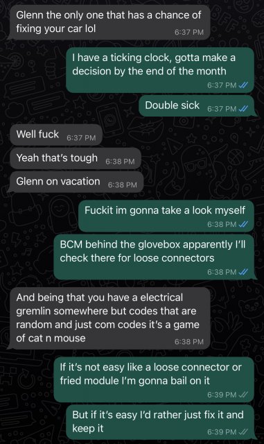

I checked a bunch of electrical connections on the car, at the bcm, under the hood etc, and can't find anything loose or obvious at this point. The car has also been fine for the past 2 days that I've driven it so who knows when the issue is going to rear its ugly head again. I do really love this car and the spec, but I have my 2015 Challenger Hellcat and race car life can be difficult as it is, I don't need a new car that could be a potential basket case. It could be a really easy fix, or it could be a giant pain in the ass and right now I'm not really willing to roll those dice.

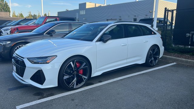

I stopped by and test-drove the RS6 Avant I've been eyeing today. Absolutely gorgeous car drives incredibly well and definitely has a Jekyll/hyde personality. It is incredibly refined which hides the speed and some of the wow factor for me, but I didn't push it super hard on the test drive. Definitely gotta wait for the turbos to light but then it's a rocket.
Long story short, I left a deposit on the RS6, the Redeye goes back to the dealer Monday.
