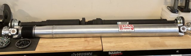

Here’s the 4in. Wiles I installed last w/e vs. the factory piece.
