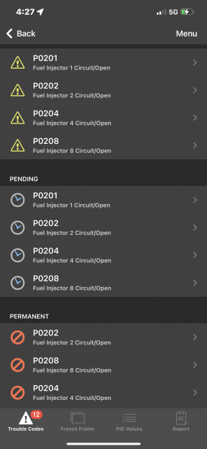

I just installed this kit on my SRT and i get a cel P020-1 through 8 depending on the injector that doesn’t like it.
I contacted PROFLEX today via phone and the guy was pretty cool and seemed intelligent in regards to e85.
He said the cel was what they call a “ghost cel” and i would be able to turn it off with hp tuners. I’m still on the fence whether i want to keep this kit or not.
This👆
No misfire or other issue, still runs fine just throws a code for circuit open. I called and spoke with the manufacturer guy and he said it’s referred to as a “ghost code”. He said it has to do with the pcm looking for a certain resistance from the injector and it’s not receiving it. He said as long as i don’t have a miss or running lean code I’m fine.
he said i can use HP tuners to turn off that safety protocol and it won’t throw a cel anymore
Again for liability reasons I wouldn’t want to shut a code like that off.
