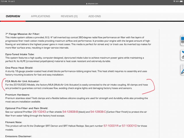

With the aFe Power CAI they include an adapter for this. C5876F48-D48A-4C6F-AED4-1D6959E761DD.jpeg

With the aFe Power CAI they include an adapter for this. View attachment 48039
This is why I said that. There should be adaptors for different years so they work. I have noticed some have that thing on the shock tower and other don't. Can't believe they made so many changes
I also noticed they may make 3 different stock air box lids. There is a 15-16 for mass air then one without it then I saw another that had a barb for a tube like the 5.7/6.4 cars have for the valve cover tube just in a different place

19+ have that emissions solenoid. 15-17 have a maf so different intake tube. 18+ have speed density so a different tube. The AFE comes with the hose and fittings for the 19+ emission junk..
