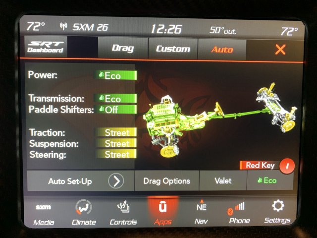

Got word back from the attendee, instructor apparently no longer pushes the cylinder deactivation, but is still negative on eco mode in HC's.

For the record, this is what the 170 Supplement says:
Eco mode offers increased fuel efficiency and quieter exhaust character, as well as a more relaxed throttle pedal recommended for wet weather conditions.
• Eco (if selected, will stay active on subsequent igni-
tion cycles): Offers quieter exhaust character, maxi-
mized fuel efficiency, and increased throttle pedal
control for wet weather. Shift paddles are disabled.
Steering and suspension settings are configurable.
I haven't noticed a change to the pedal or exhaust based on a few dozen miles driving around town, but the difference in the trans it huge! I'm guessing the bulk of the "eco" is earlier upshits on mild throttle and the less aggressive downshifting.
I plan to keep it in eco unless I plan to play a bit. ;)

Here's what I've observed with ECO mode on a Hellcat:
It limits boost pressure to a mutiplier (fraction) of max. So on a stock hellcat you get about 5psi as the bypass opens to bleed off the other 6psi.
HOWEVER, the car DOES NOT enter PE (power enrichment) at WOT so it stays at 13.5 AFR on gasoline. This is not what I'd program it to if I were the calibration engineer as 5psi of boost at WOT and 13.5 AFR would get things too warm EGT wise for my taste.
I've never tested it on the 170 but my gut says it acts the same.
SO, my OPINION, if you're just cruising around then no harm in ECO but do NOT go WOT.
As an added note, on the Hellcat when I went to smaller SC pulley and upped the boost, I made a lot more than 5psi in ECO mode which is quite dangerous actually to the engine. That's how I learned about the multiplier and the need to go in and rescale it to maintain a lower boost threshold. I did this through the black key multiplier table. I'll have to look at the 170 tune file to see where it is in there.
I don't think that'll be a problem, I don't believe there is anywhere I can legally give the 170 WOT except the dragway! :)
