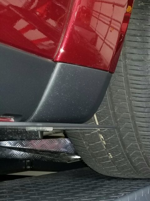

Yes I had the exact same protection on my 18 when I bought it new then saw what was happening to the grey lower moulding at the bottom of the rear wheel flare. I then purchased ZL1 side skirts and problem solve.. 20190323_160035.jpg

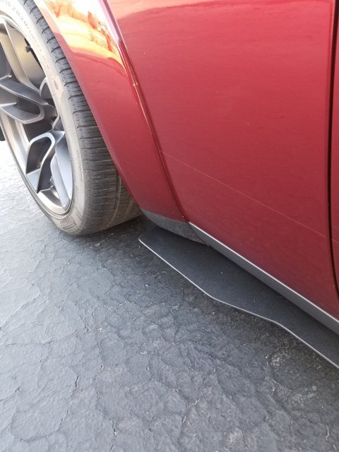

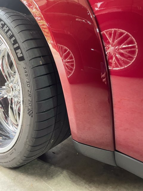

Update: FWIW, I ordered from https://www.vicrez.com/vicrez-custom-side-rocker-panel-splitters?search=custom
They have a standard width skirt. However, I was concerned a skirt for the normal body may not be as effective on a wide body. So, I ordered "custom" with a "straight side" instead of the "modern" as is offered by them as well as the more popular brand.
The price was lower and includes shipping. I got a nice discount coupon as well.
