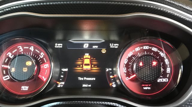

I looked at your pic for 3 second and almost had to commit myself . Lol

And that’s only because it’s been in the garage with the batt disconnect. I’ll be driving it over the wheel alignment shop in a hour and at one mile the check eng light will come on because of the fuel system I’ve got. There’s no fixing that. These lights are what assure me that it’s still a Hellcat because a race car wouldn’t have those. 😝

Airbag/seat belt light = easy fix ( someone makes a bypass harness).
Tpm = easy fix ( can be disabled )
Why is your ABS on?
Check engine lights can be turned off in tuning .

The check light can be turned off using my Trinity but it comes back on and there’s no permanent fix apparently. Lol. This thing has had more tunes in than I can count. It has to do with my 1700hp fuel system and there’s no getting around it. The ABS is on because it’s a auto car with no TCM. That’s confusing to me but it happened with the trans change and it was like wtf. It doesn’t seem to affect anything so we haven’t spent any time chasing it. The PCM in this car is so hacked, it doesn’t know whether it’s coming or going.

We need to get into the bcm to turn off the abs , tpm, etc .
What is the code for the check engine light ? If it's a P code it should be able to be disabled. I have a few check engine lights disabled in my car . I use hptuners though .

Haha. That was my intention. The BCM was hacked by HemiTuner as a part of the auto to manual mod to get the T400 to work. Who knows what he does to that stuff. We actually had to mod the wiring harness to the PCM. We’re off the map with this thing now.

I guess this one of down sides of being "one of the first" . You really don't know what will happen . I wonder if stuff like that could be turned of with Alfa obd as it can read the bcm?

Don’t know. I’m operating on a if it works... don’t fix it.

You can see what my average mpg is in the picture. Don’t leave home without a full tank. 😂

my abs was off with my th400

Which ones stay on all the time, when you drive it regularly (If you do)

All of them.
