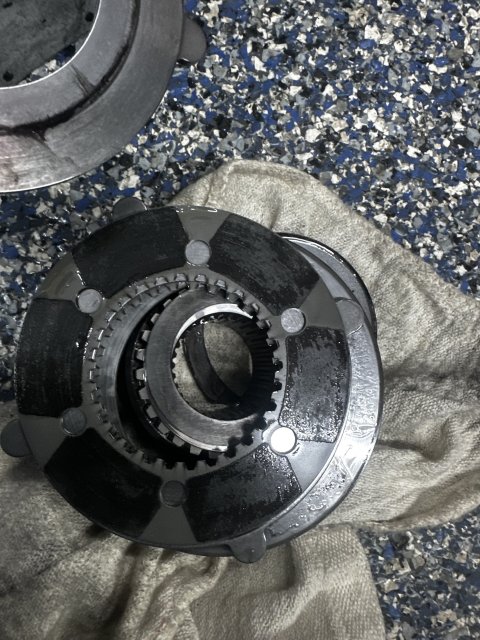

I have set up a couple. Nice unit. The clutch’s in a stock diff don’t have a lot of friction on them

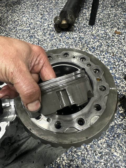

anyone here use the wavetrac an what has been your experience or opinion.
past weekend at the track car was wanting too do the one wheel peel a lot an broke left axle:(
70415475331__4F3682E0-E182-42F0-8785-59B41E44D0FC.jpeg 70415474350__A4EEBABD-16D5-4686-95E5-DE4E74BB7236.jpeg 70415476890__05684356-D9DE-4802-9C22-05BC911D4B00.jpeg

can`t find after market or oem clutch kits for stock diff. do you know of anything? I have never been impressed with the oem diffs in these cars. I guess dodge thinks of it as a bic lighter, any problem buy a new unit:confused:
I have 3-4 sets of clutch’s. Can’t buy them separately have to get whole diff.
Wave trac has lifetime warranty

Just ordered my wavetrac thanks to speaking with @Hatermkr (also thats my diff he setup in the pics)
if we are interested in clutch packs for those that dont want a wave trac i need a stock set of clutches, unused. I can get them into cad and get a test run machined. I know a clutch manufacturer.

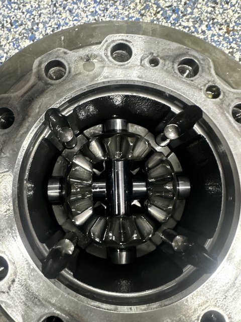

Does the spline on the stub shaft have the same depth engagment as it does with the stock diff?
Yes to a tee
