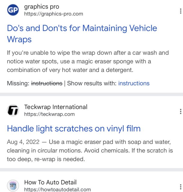

I did some searching on the magic Erasers.
🤣 Oh boy, Magic Erasers are like the wild card of cleaning tools—miraculous on grime, but savage on finishes. Some of the “don’t even think about it” warnings people share are downright hilarious (and a little terrifying).
Here's some good advice for you guys :ROFLMAO::ROFLMAO::ROFLMAO::ROFLMAO::ROFLMAO::ROFLMAO::ROFLMAO:
"Don't clean your genitals with it ever! Unless you're trying to do selfie gender reassignment. Even then, I'd advise going to a licensed doctor who has a little experience in that field."
:LOL: Why would that even cross someone’s mind?
