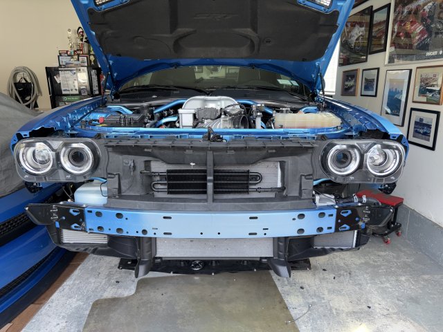

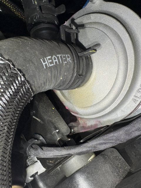

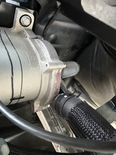

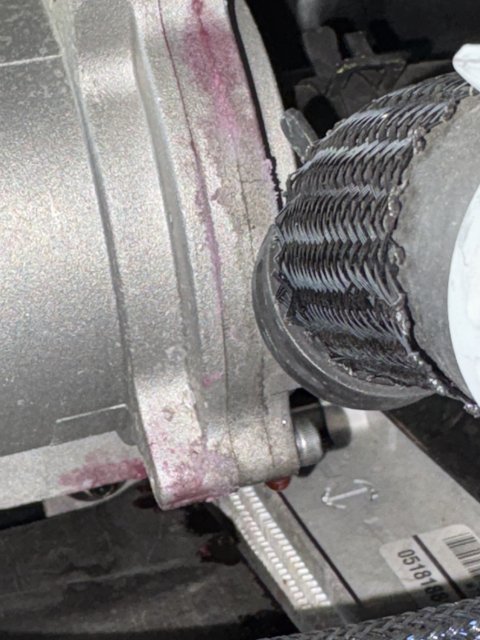

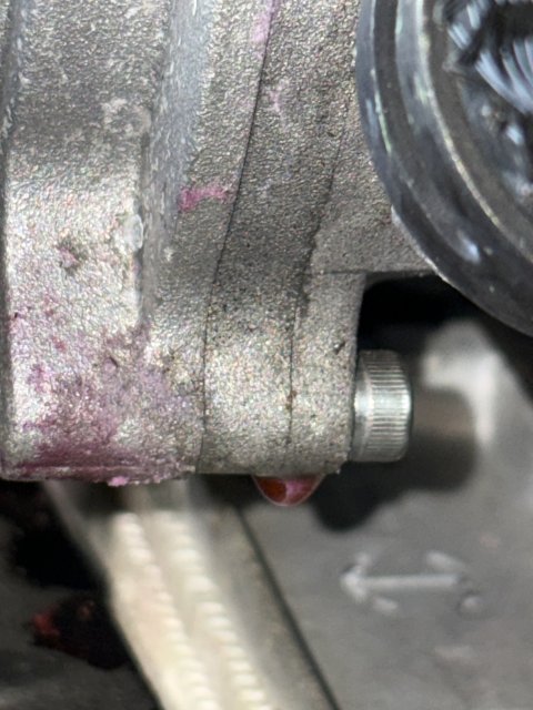

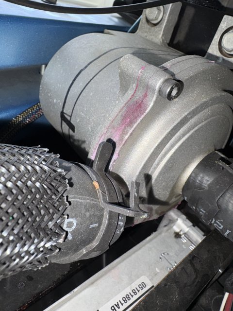

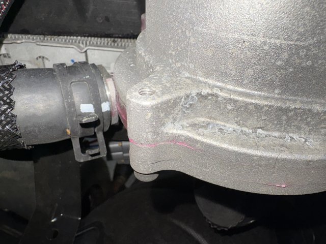

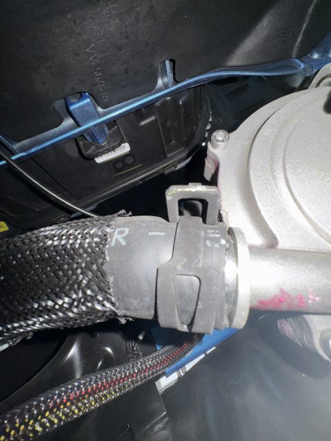

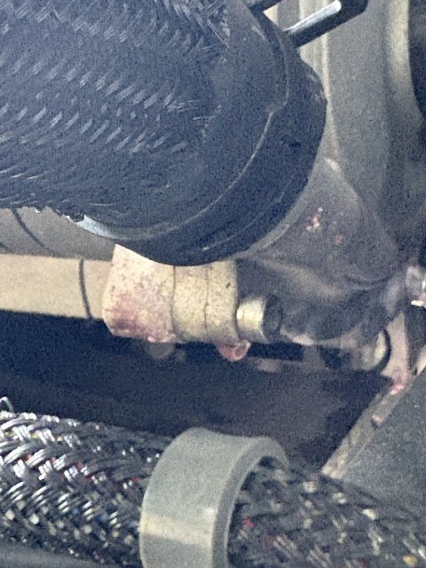

UPDATE!!! Do you guys think this is a supercharger coolant pump leak?
2,697
7,402
Thread Starter #41
Interesting to note. I use concentrate and dilute 50/50 w/distilled water.
2,697
7,402
Thread Starter #42

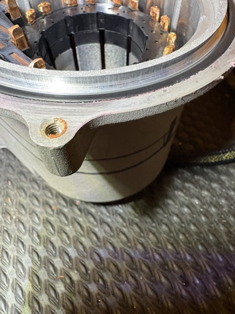

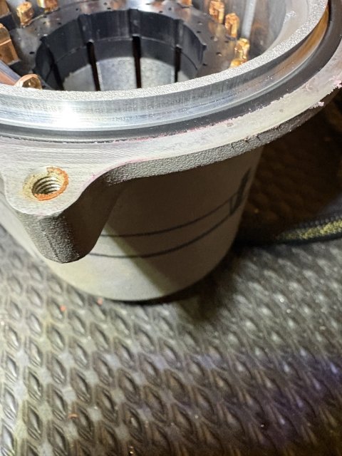

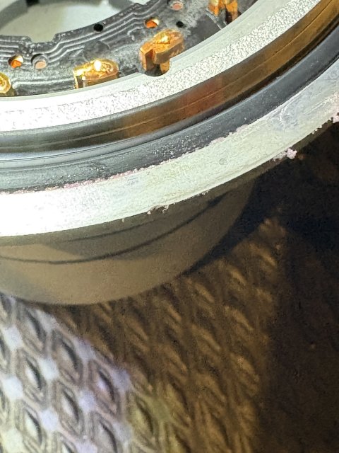

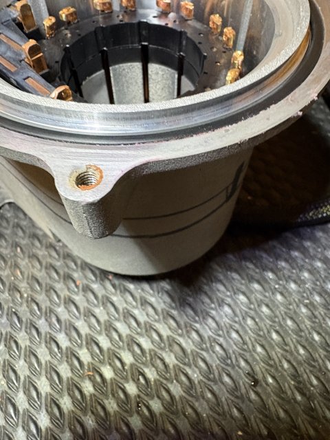

Did you have to take the plastic cylinder that turns the pup off the other side, or could you have kept it on? Curious what you had to do to get the front cover off
If I’m understanding you correctly, I could not have left it on to replace the o rings. I removed it as the 4 small screws holding it also held that third portion of the pump.
2,697
7,402
Thread Starter #43
2,697
7,402
Thread Starter #44

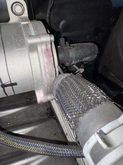

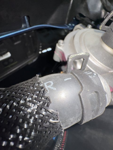

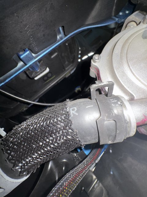

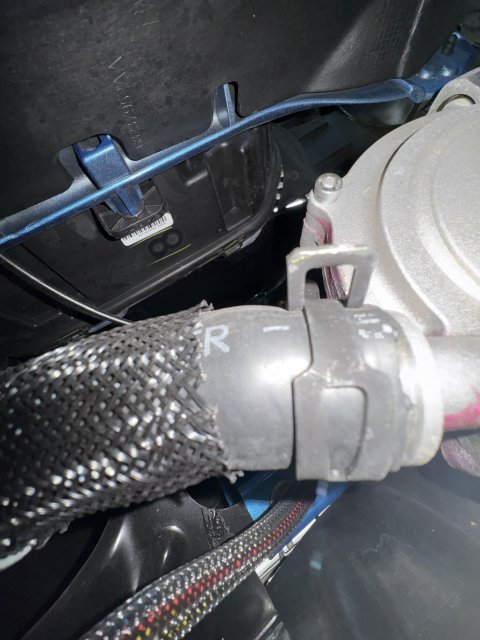

By the way guys, forgot to mention, I also tape wrapped the pump harness as I’ve heard complaints about the leaking pump corroding the contacts.
2,697
7,402
Thread Starter #45
Topped off coolant, code gone, I reblead it just to be certain. Put another 70+ miles on today running around then down to the beach. Temp stayed 10* above ambient. Still no leaks, we might have won one here. I’ll check level again after it has cooled. I don’t know why I cant load pics as usual here, but whatever…
