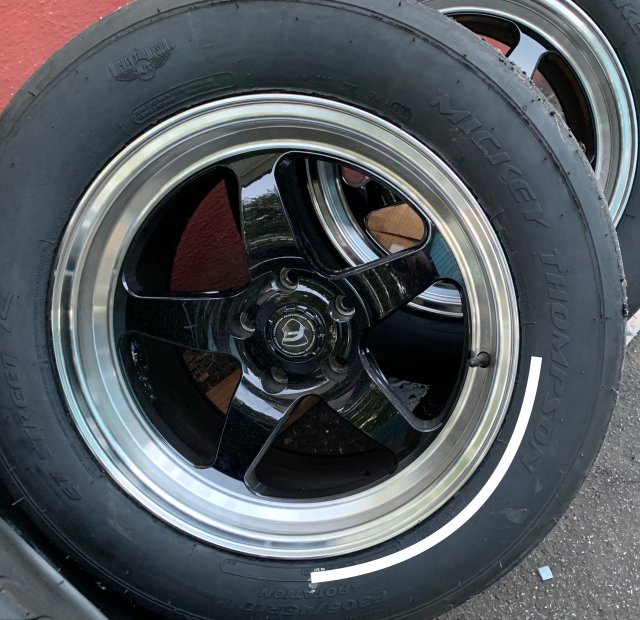

So out of curiosity I marked my new set of MT ET Rs that I just ran at the track. I made 3 passes on race start recluse 17x10.5 wheels (non beadlock). The left side seems to be the side that moved more (about an 1-1.5 inches a pass) the right side moved about 1.5 inches after 3 passes (about a 1/3 less). I also noticed the left side always seemed to throw down more rubber than the right side after burnouts. My 15' hellcat was the same, left side seemed be more torquey or dominate than the right.
Keep in mind I have a Redeye on stock power and I used Hi tack glue to keep them from moving. Hoping they settle after a bit and won't move so much, down the road. Otherwise beadlocks may be in my future. The other thing I was thinking though was that the tires shifting a bit like that might actually help take some of the drive train shock load. I've gone a best of 1.47 60ft with previous tires and 1.55 60ft (worse DA) this weekend with these tires so they seem to 60ft pretty well.
Does anyone think beadlocks would improve my 60ft times or reaction times? Or am I overthinking this? lol
Left side pic (worst movement, after 3 passes)

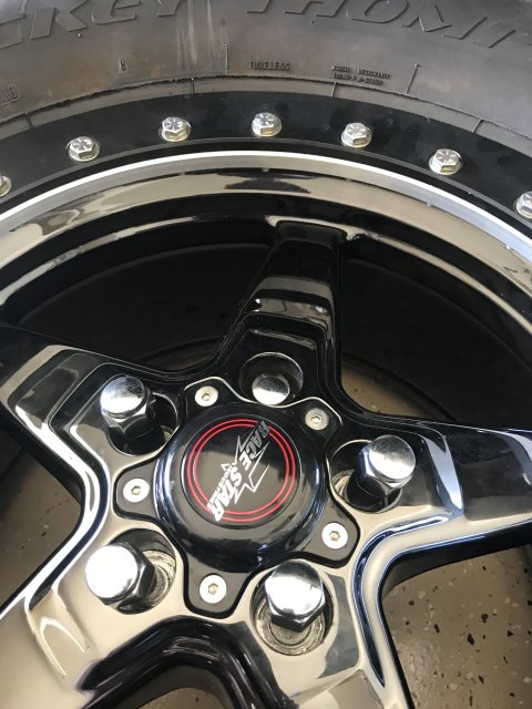

Bead locks will most definitely eliminate tire slippage on the wheels. FA4F86B7-BEAD-406C-87C2-C5B7A0B7AAA3.jpeg
Not the best pic. But my race stars are bead locked and had them widened from 9.5 to a 10 inch. I bought these off a forum member in here that had all the work done to the wheels before I bought them.

Bead locks will most definitely eliminate tire slippage on the wheels. View attachment 3178
So you are the lucky one that got those.👍
