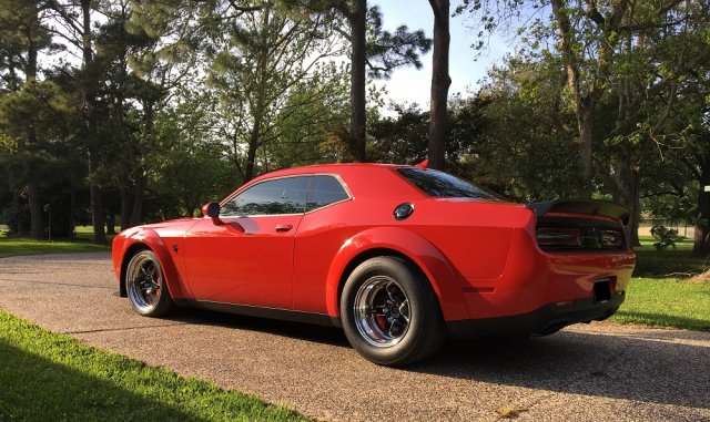

Basics on the car as it sits, if it makes a difference.
2020 RE WB
3.09s
No sunroof
Factory rear seat delete
8-speed auto
Rolling on 20x7 Welds on the front and 17x11 Welds on the back with 315/50/17 ET streets
