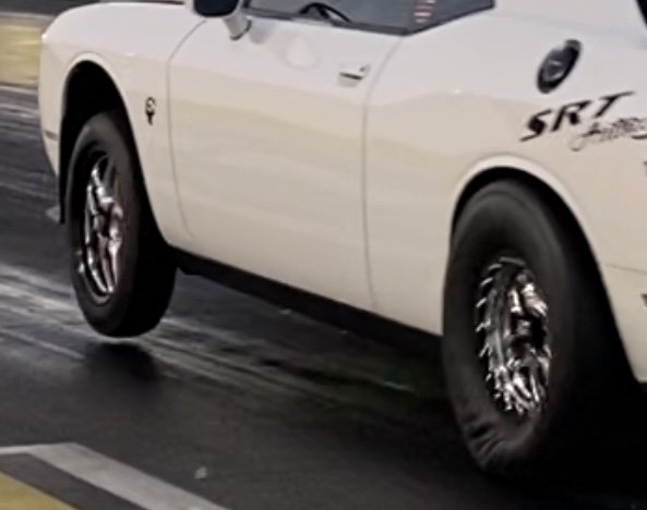

Wondering what you guys are running for rear suspension setups.
Talking with AAD after I installed my rear control arms, he wasn't too wild about the demon killer springs with the stock shocks. His advice was either swap shocks or go back to stock springs in the rear.
I'm currently running the 3.09 rear end but made a few changes at the same time, so not 100% what caused my traction issues to magnify at the track.
I enjoy the drivability of the 3.09 other than the gear noise, so I'd like to stay with the 3.09 if I can make things work
My current setup for track days is demon killer rear springs, viking shocks, AAD rear upper control arms, BMR trailing arms, BMR cradle lockout
I struggle to cut 1.5 or better 60's. I recently swapped to Hoosier QTP in a 28x11.5-17 which measure 29.7"
They seem like they might be the ticket, but I blew the engine on my second pass with these tires.
Curious what everyone else is doing to achieve 1.4 and better 60' times.
I'm currently leaving in 2nd gear and have had no luck on 305/45 mickey thompson et street r, and very limited luck on the Hoosier DBR 28x11-17. I was hoping to not go with Mencer coil overs but might if that's my only option. My biggest concern is that I daily drive the car and it's our family car when it isn't broken. I don't want to add any noise, or handling issues with drag racing coil overs but I'm not even sure if they would create any noises, or handling issues

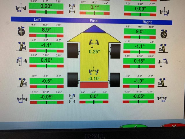

This is what was sent too me !

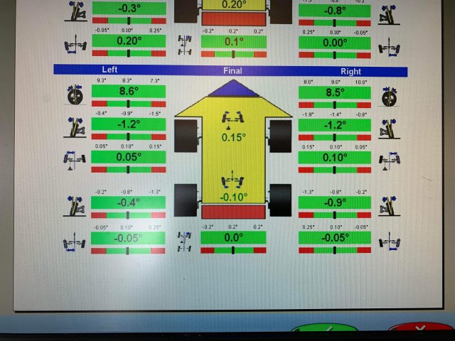

I forgot I am a little positive camber in the rear. I'm not sure if toe was adjusted or not
