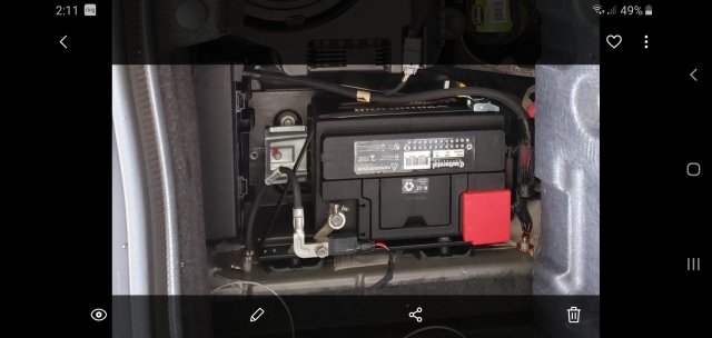

What is the stock battery in a 16 challenger hellcat? Does Dodge use Continental battery’s?

2016 Hellcat Challenger
Whatever this is.

That looks like my battery but mines a Continental. Has the handle and red cover just like yours.

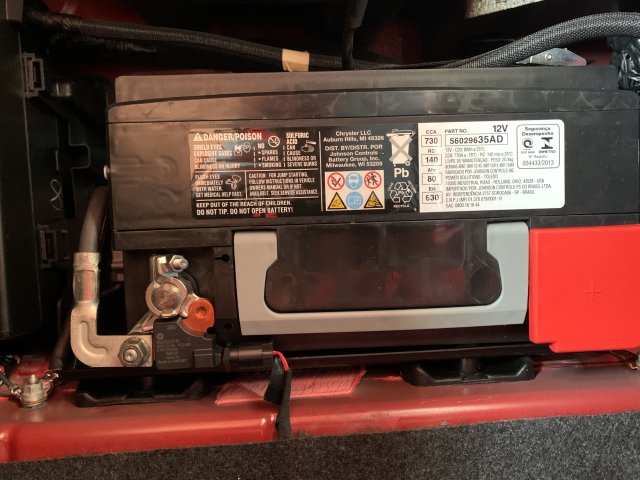

It's right on the battery, the label in the center with the symbols - made by Johnson Controls (they make many different brands Diehard, Interstate, Optima, Motocraft etc.).
Only 2 other companies make batteries in the US - Exide (mostly Champion, Exide & Napa) & Delphi (mostly ACDelco).

My 16 also has a Johnson Controls.

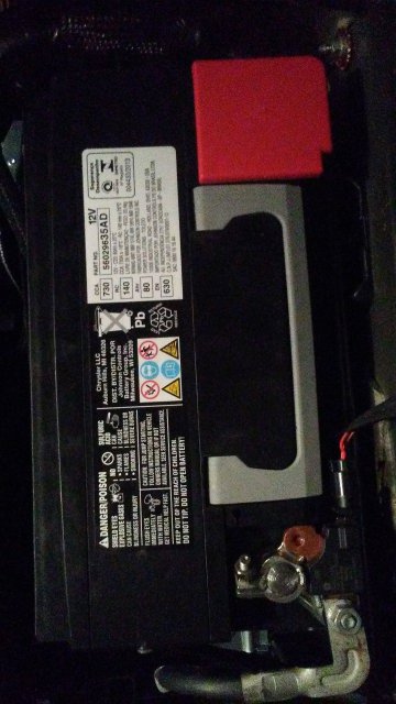

What I'm trying to find out is did Dodge put the continental battery in the hellcat in 16, because mine is a continental and it died and my car is almost out of warranty. I bought the car used at one year old with 3200 miles on it. Dodge has no record of the battery being changed. I dont see why the original owner would have bought a new battery being that the car was under warrenty with less than 3200 miles.
If Dodge didnt put Continental batterys in the car I guess I gotta pay for a new battery but if they did its cover under warranty.

Well for sure they did use Johnson Controls as I bought my 16 new less than two months after it was built. It only has 6 miles on it. That does not mean they did not use other manufacturers batteries as well. You just need to get other 16 owners responses. Time built is a factor too. They use what they have on hand and often use other suppliers to avoid delays. What is build date on your car?

Some other factors may be a date code stamped in the battery somewhere? It’s not visible in mine but battery may have to be out to see it. Also does yours have recessed areas for cable attachment and red block cover to fit? Ir flip up handle I bet was required to save workers backs.

I would doubt that Dodge put that in @ the factory, Continental is sort of a 'boutique' supplier, meaning they are higher cost & have limited production capability. Tho it's possible if there was some issue with the supply from JC for a short period & they had the necessary stock available. Even then, I would expect FCA's name would be on it somewhere just like the ones from JC.
More likely the OE battery croaked (like mine did) since the car sat for long periods & the owner decided to put in a battery he perceived as higher quality rather than fool with another OE one.

The car is under 3 years old by a couple of weeks so it's under warranty. The build date is 4/16. Here a picture of the battery. Looks just like Jungle cats battery. Screenshot_20191103-141149_Gallery.jpg

That could be original. It has correct configuration . Your car was built 5 months after mine so it’s possible that’s what they were using at the time. I notice yours has the dots on top you punch out dates. Can you make that out?
