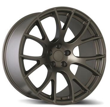

Has anyone had experience with the Replika 179A wheels installed on the rear of a 2016 Challenger Hellcat?
20x11,5x4.52, 5x115. I think the backspace is 6.75.
If not would they fit? Sorry I'm a newbie.
Thank you

They fit with slight effort with a 305/20 Nitto 555R. They are close but didn't rub on my car.
They are from Fast wheels in Vaudreuil.

I had to adjust my inner liner and stick it to the inner wheel well with 2 sided tape. Just to tuck it up against the body of the car and not flop around on the push pins.
