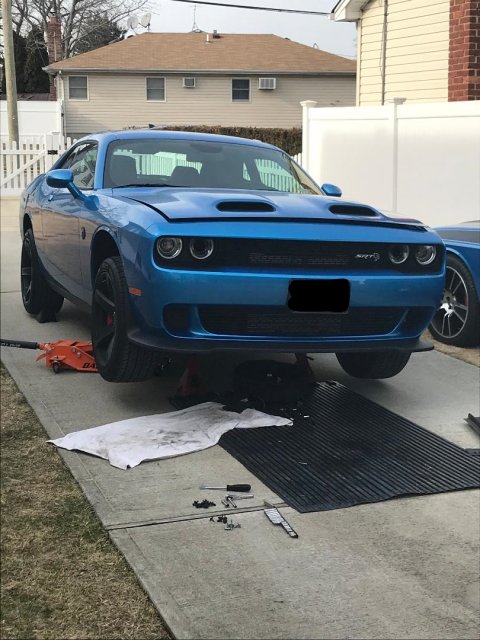

Yesterday I did the first oil change on my Red eye at 577mi. Was waiting to break 500mi to do first oil change even though most go 1000 or more and oil life was reading 91%. I'm old school, I always change oil on a fresh engine at 500mi. Started yesterday off at 479 and when I got home it was 577 so I just changed it. I've been looking at oil capacitates for Hellcats and again nothing but confusion and no definitive answers. Some say 7 (with oil filter change), some say 7.5 with cooler, and some say 6 (because I believe even Mopar made a mistake and printed it wrong one year in the owners manuals) AND there were 2 different oil dipsticks made also over the years o_O. Thanks Mopar!

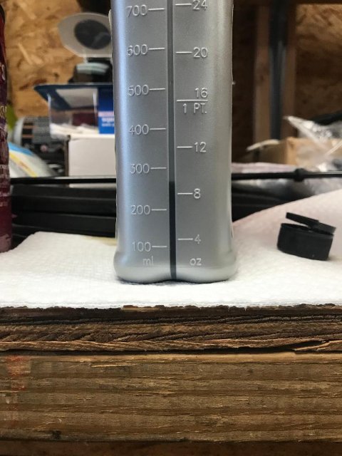

2) Some say the oil cooler only holds a few ounces and it's not worth draining. I found mine had at least nine. I drained it directly into an empty oil can and then put that amount into an empty oil quart container and recorded the amount. It was then that when I went to fix 'a problem' some slightly more had drained out and on the ground.

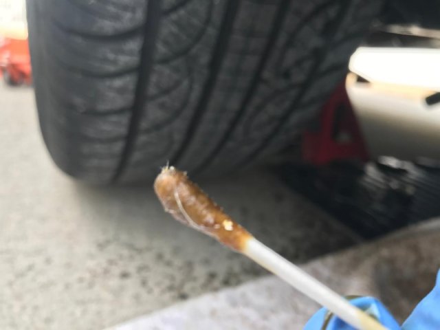

SIDE NOTE (the problem): When I removed the oil cooler bolt it was barely torqued down at all and had 'drag' on it the whole way out. Came to discover the bolt had bad flat spots on the threads and was binding/scoring the aluminum threads into the cooler housing. Thank god no cross threads. I filed the bolt threads with a micro file at flat spots and cleaned with a brass then stainless wire brush and came like knew. I recorded some of what I pulled out of the cooler threads also. Put bolt back in on cooler and pan and torqued both to 20 ft. lbs.
