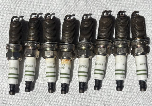

…and if you want to see what 6 year old 53k mile spark plugs look like on a stock tune redeye:

I don't see anything wrong with those plugs other than you need to romp on it a bit more often :LOL:
I don’t recall my stock plugs being Bosch but that’s a 2015 regular hellcat
Surely you jest! :ROFLMAO:

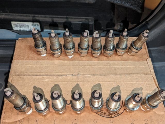

52k miles, stock 2017 HC plugs:
