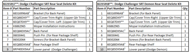

The issue I'm having is that FCA won't let me order the DEMON version of the kit. To the best of my knowledge there are two versions of the kit:
82215917 - the SRT Challenger Version
and
82215918 - the SRT Challenger DEMON Version.

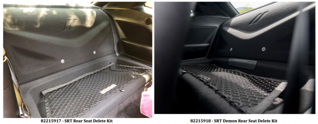

What's the difference? The Demon version has a cutout and plug as part of the lower panel:

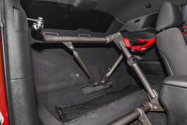

The plug is so that you can add the Harness Bar:

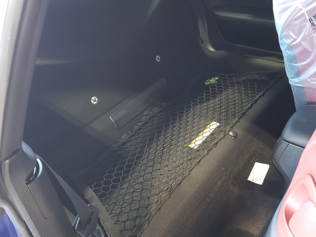

Below is a picture of the interior of a 2019 REDEYE with the factory ordered rear seat delete option (AEW).
It clearly comes with the "DEMON" version. So how do I get this kit for my 2019 Redeye? FCA is telling me that I can only order the 82215918 Demon kit by providing a 2018 Demon VIN. I tried a work-around by supplying a Demon VIN that I sourced from the internet - but then they asked for proof of Demon ownership. Using my Redeye VIN didn't work either.

I just got my Redeye and ordered the factory seat delete. And it has the removable center cap.

Did you order the car with factory seat delete, or did you order a kit aside from the vehicle build (install after delivery) ?
I did order mine this way from the factory. I think it was $1.00 for the option!

are you planning to install the harness bar?
I would definitely like the option to do so. I know that some have ordered the regular kit, then the plastic cap separately, and cut a hole to fit the cap. I would just rather avoid that.

Thanks, its by AAD! They are great to work with and honest! I have a fire extinguisher mount coming that I will run on the front down tube!

The P/N of the closeout panel is in the first photo - go check again. I ordered one the other day and it's on the way...

Just order the kit for the redeye it is the same as the Demon just without the logo in the plastic cutout.
Could u tell me what item number it is on the list. I will track one down as well.
68423573AA
