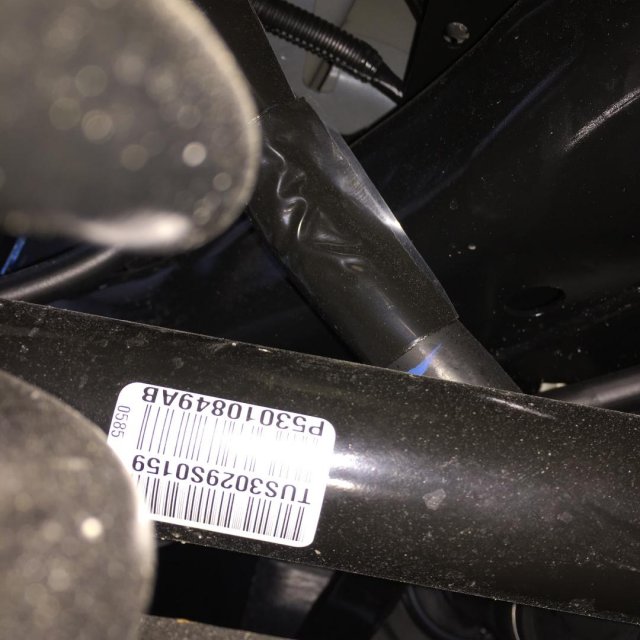

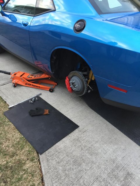

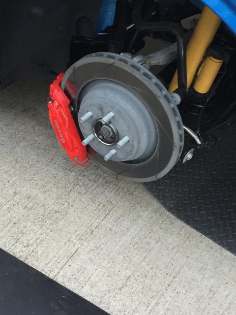

I still find it very hard to find info on Mopar in general (at least info that is pertinent to or interests me. LOL). I'm sure this has been gone over many times on both sites but I couldn't get a part number or a real world dimension on searches so I jacked the RE today and measured the rear axle. I wasn't in a very good position as I wiggled under the car but I tried to mic the axle as best I could. It came back 40.18 (1st time) and 40.22 (second time). So I'll round it and say 40.2 axle diameter. Then I tried to get the numbers off the axle to see if it came back as a Demon axle when I googled it. When I googled both numbers on the axle tag , I got nothing. Nada. The P53010849AB especially looks like a legit Mopar part # to me.
Ok these are my questions:
1) Are my axle measurements good and is that the Demon axle diameter.
2) Why are both these numbers coming up empty? Does anyone know what these are or what is the actual Demon/ RE rear axle number?

Ok I’m back we can put that myth to rest ! That’s my part number also..P53010849AB and 48AB
Thanks! BUT is that the Demon axle and is my measurement of 40.2MM (which definitely looks beefy) the correct diameter?

Yes Tony I believe we have the Demon axles but I need more info. Let me know if you find out anything. I’ll talk to the dealer tomorrow. John

Thanks a ton John. I didn't realize you were going to check the actual axles on the car. I thought you were gonna look up some info you had. LOL. You didn't have to do that. I am just baffled that nothing comes up on google on that number. Also can't find a definitive measurement on axle diameter.

They are the same axles as the Demon. Doesn't matter widebody or regular body, 2.62 or 3.09.
