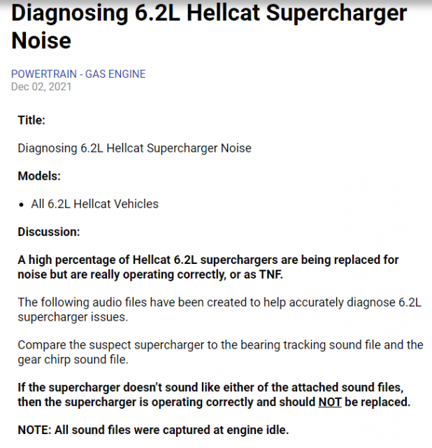

My service mgr is looking into it. He sent me this and some Stellantis reference sound files.
He doesn’t think that the noise is the same as mine. I’m certain mine will get to be as bad shortly. My plan is to drive it hard for a couple weeks and take it back like unholy suggested.
Wish we could get those audio files
That is a lame cop out.
These things can fail any number of ways. Eating bearings seems to be the most common. That being said, I don't know how you can enforce an arbitrary standard, using a sound file for reference. Lame.
I guess they can wait it out and spring for a new engine, when shit let's go and dumps into the heads. Tell him that.
