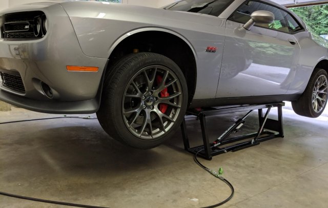

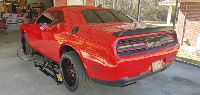

The rear is bolted to the cradle so it doesn't move no matter how you jack the car up
But if you jack it up by the diff center section it will move upward on the cradle because you are compressing the bushings that hold the diff in the cradle.
