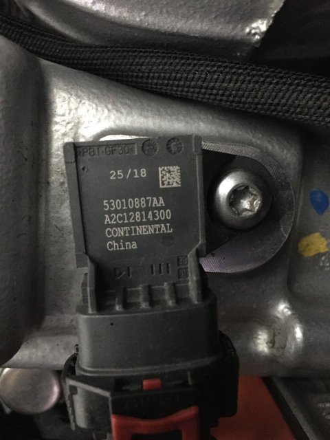

Was driving my 2019 Charger Hellcat today and at full throttle got a electronic throttle control error message pop up and the engine MIL light. After parking, reviewed error codes and got P0106 and an email from dodge also warning about the MIL and electronic throttle control. I recently installed a JLT cold air (about 300 miles ago) but didn't see how that could cause an issue. I checked the area just in case and found no dislodged connectors or any noticeable issues. After playing a round of golf with my son (we suck really bad but think its a riot) started the cat back up and drove home. Code and MIL still there but no issues driving the car (didn't appear to be in limp mode but I didn't push it.) Did some research and read my Tech Authority USB service manual. It indicated that P0106 is for Bank 1 MAP sensor located on the right hand side of the intake manifold. It had some troubleshooting instructions but as usual I eliminated the unlikely scenarios and went with the 99% likely problem (unless its a really expensive item then I might screw around a bit more.) Got the PN off the sensor (noticed its made in China) and called my local Dodge dealer parts department to confirm they had one in stock. Drove the cat to pick it up the sensor. Things looked like a big mess at the dealer, was happy to fork over my $60 some dollars rather than let them touch my car. Yep its under warranty and nope not worth saving the money letting them fix it. MIL light and code stayed on through all this. Went home and changed it. One bolt and one connector, took about five minutes (had to find a bit that fit it.) Started the car and the MIL went away but the code is still listed under faults.
So my questions. Will the code eventually clear? I'd rather not do a battery disconnect but if that is what it takes I will. Can I use a cheap scan tool to clear codes via OBDII connector? Is there any issues with doing so on 2018+ models with the security gateway OBDII port protections? Anyone had this code before and want to share? sensor HC.JPG

Purchased an inexpensive code reader-clearer on Amazon and got the code cleared. Couple days and a fun weekend cruise later and no issues. Glad it was something so easy.
