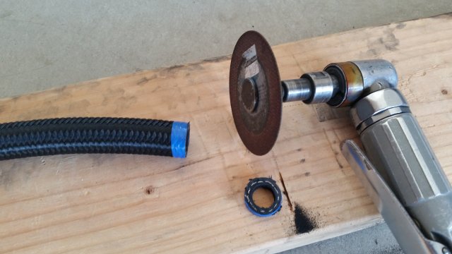

As I said, the first challenge to overcome was the hose, I ordered it (and the fittings) up from Summit, although I'm sure others have them as well. I ended up using a cutoff wheel, and the results were very nice, with the only down side being that you've got to clean out the inside of the hose, which isn't difficult to do if you have compressed air available...
The cuttoff wheel is a 1/32", what makes it work is that it has a fine mesh to it, it melts the nylon and rubber while cutting the steel braid. The 1/8" wide wheels are typically a coarse mesh and don't do as clean of a job...

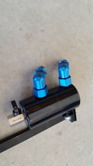

Bob's Catch Can, with the AN fittings installed. I noticed that the clocking of the two ports isn't quite perfect, no harm in the end... Keep in mine that the two halves are threaded together and the threads on the two lathe turned parts have to be perfectly timed to then make the ports line up. If you tighten the two halves differently, then the ports with be different...

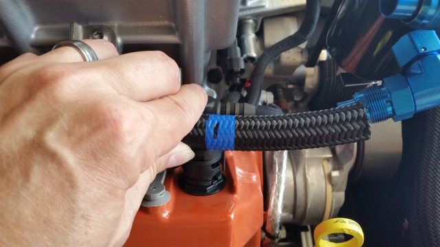

Installing, with AN fittings, position the hose as such, then thread on, tighten and check for excessive hose movement, this is about as much as you should allow for. Given the nature of this installation, (low press and vapor, no liquids) I accepted the little bit of push out... (Oil up the threads and inner hose wall with light oil)

First hose installed....
Second hose, pay attention to the routing, if you put the harness on the other side of the second hose, it gets bound up... (Sorry about the picture rotations...)
Cutting the second hose to length... About the same amount of push-out as the first hose, again, acceptable by the AN standard for normal use, more than fine for this application.
The hose pushes on this sensor a bit more than I'd like, but keep in mind, if you were using the heater hose, it'd be worse as the heater hose is stiffer...
