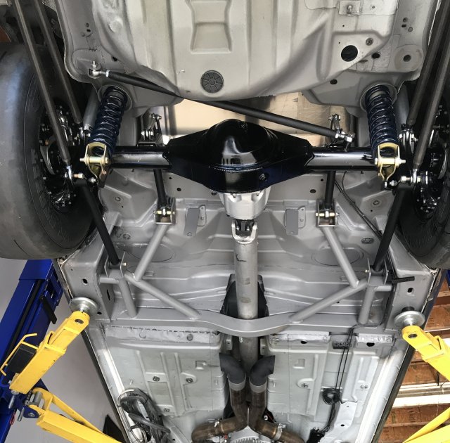

It is official. Here is the build for this offseason.
Engine:
2000 HP Plus Hemi 411 Stroker kit by MMX.
Features
  • MMX Spec Mahle Box in Box forging for increased strength and Piston Stability
  • 1.5/1mm/2mm Ring Pack
  • Anodized Top Ringland
  • Grafal Coated Skirts
  • Increased Fireland Distance Over our Normal (411/422/426) Stroker Piston
  • .200 Wall H13 Tool Steel Wrist Pin with DLC Coating
  • Thermal Barrier Top Coat
  • 9.6CC Dish, 10:1 Compression W 6.2/6.4 Head and .054 Gasket.
  • Valve Reliefs for up to 2.200/1.675 Valve Arrangement
  • Callies Ultra Enforcer 6.200 Connecting Rod 2.100 Big End, Multi Phase 3.5 ARP Bolt
  • Winberg Billet Center Counterweighted, 3.900 Stroke Crankshaft with M16 (Hellcat) Bolt for extra clamping force in blower applications and Additional Keyway 180 Degrees from the STD Keyway location.
Thitek ported race heads
Cam: to be determined
Blower: Jokers full tilt porting and some other secret sauce. Not to be disclosed at this time.
Rear End: some secret sauce to keep hookin over 99% of the time
Misc: Cage it and Parachute
Summary: Let's see how far we can push this 2.4 blower and manage our heat problems. We race this car over 35 weeks in 2020, so car needs to hold up and keep wining events.
Goal for 2021: Go faster and safer than last season and maybe go for another record. Let's see....
We won 7 events and placed second in 6 events. So let's increase win total, keep the reliability of the car at 95% and go fast AND HAVE MORE DANG FUN!!!

Did something in last year's setup fail? It sounded like you had a winning combination, so just curious why the serious overhaul - other than the sickness we all have, of course.
Dman007
Dman007
6 Second Best E/T
#1787
559
1,090
Smyrna
2019 Charger Hellcat
Jack,
Nothing really failed. We had our issues last year...
Broke stock axel after we upgraded over 1k whp. I did not listen to Allpar Garage and did not replace them. Wanted to save money and was thinking of upgrading to 9" or solid. I broke the axel in a championship round and lost 1st place and we had the better car. <insert curse words here> lol
Then we changed out the stock transmission after 300+ pulls. Increased power load on a stock transmission...had too many pulls on it and 2nd gear was shot.
Stock throttle body is not for racing. It is good for glory passes and daily driving. But not for racing the car in competitions. We upgraded to a Kong 108mm.
Then we had belt slippage on 2.5 pully, so added tensioner.
All in all, lessons learned.
But this year, want to run even faster than 8.7 in -300 DA and run even faster in the heat of the summer. Heat really kicked our asses this year. Racing a car in 90+ degrees takes a toll on the car. We bought 180 lbs of ice for one day of racing. Thus we have plans to combat heat in the blower.
