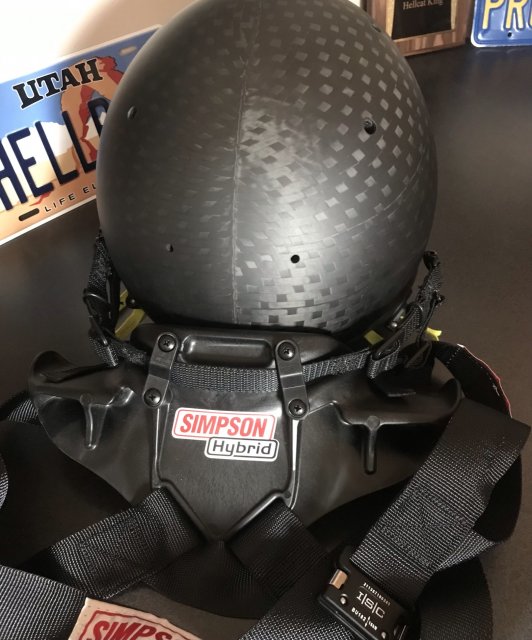

Kinda weird that they even bothered with the et part of that. 150 mph pretty much covers the concern and a car running 150 isn’t even close to a 7.49. The chute requirement doesn’t have any et attached so…. 🫤. I use one of the Simpson Hybrids and it does a excellent job of controlling helmet movement without banging into the helmet like the Hans. Another factor in protecting you neck is the weight of the helmet. Get the lightest one you can afford. A9743EED-4C6A-4B8C-96B4-56260C24465B.jpeg

I’ve used the Hans for some time. I switched to the Simpson for a couple reasons. If you look at the Hans, it sticks up behind the helmet with tethers that are higher than the Simpson. My helmet was always banging up against the device and it was annoying. I was always aware that it was there. Also some reports that the top part of the Hans can get hung up on anything overhead when trying to get out in the event of a crash/fire. The Simpson does a better job of limiting the movement of the helmet in all directions than the Hans and the strap on design is more comfortable when on.
