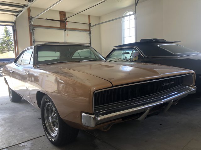

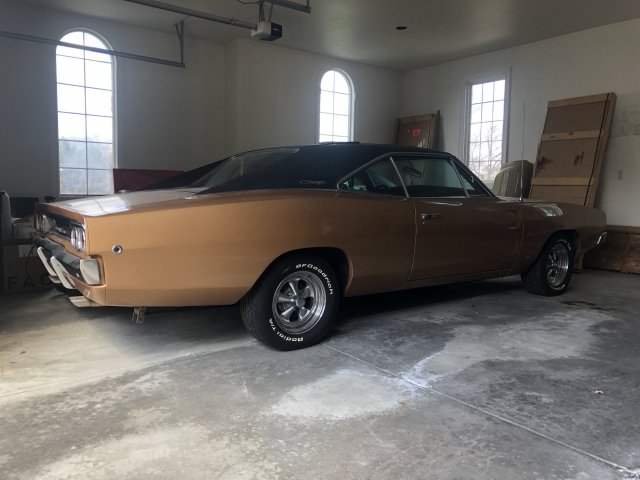

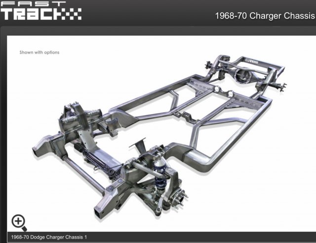

I joined this site to learn what people like and dislike about the Hellcats, in particular the motor. I have a 68 Charger that i’m prepping / researching to do a restomod on. I’m on the fence on doing a Hellcat create engine or going with built 440. I’m ordering a complete chassis for it from the Roadster Shop and need to make a decision so they can put the correct motor mounts and the correct rack. If anyone has any experiences or insite on the Hellcat swap good or bad it would be appreciated.

Welcome to the site and Dodge ownership. That is a beautiful car and one of the most cherished Charger model years. If you are putting a complete RS chassis under it, then by all means go with a Hellcat engine. Anything less will be a bit "ho-hum" compared to the rest of the body / chassis combination. That car will DESERVE more than a 5.7, 6.1 or 392. Go for it, you won't regret it.
FYI, I'm doing a resto-mod '69 Cuda. I first bought a MP 5.7 crate motor; upgraded to a 6.1; upgraded the 6.1 with a full stroker kit, heads ported, etc, etc but nothing was really good enough for how the rest of the car was progressing and being upgraded. I finally got a nice, new Hellcrate engine for it and feel "content" now. lol

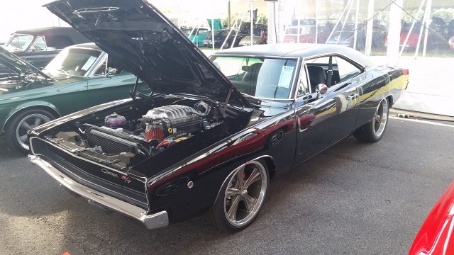

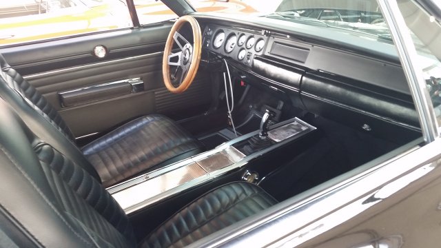

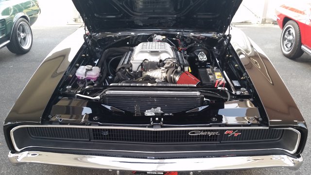

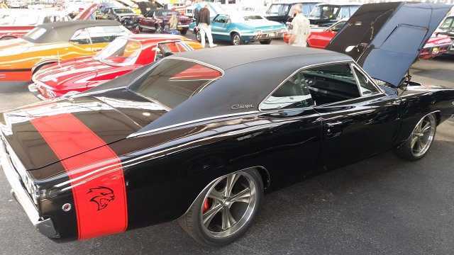

I was in FL for biz this week and stopped by Mecum. This car got my attention for sure - done nicely. It hammered today for $150K ($165K with buyers premium).
Good luck with building your 68 Charger !! 20210115_093039.jpg 20210115_093047.jpg 20210115_093113.jpg 20210115_093126.jpg

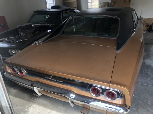

Is that a 69 Camaro in the last picture, sitting next to the Charger? The one with the tunnel ram intake? If so, what's going on in the headlamp area there? Kinda hard to tell from the angle of the photo...
11,710
19,827
high rise intake manifold and double pumpers.... yum
