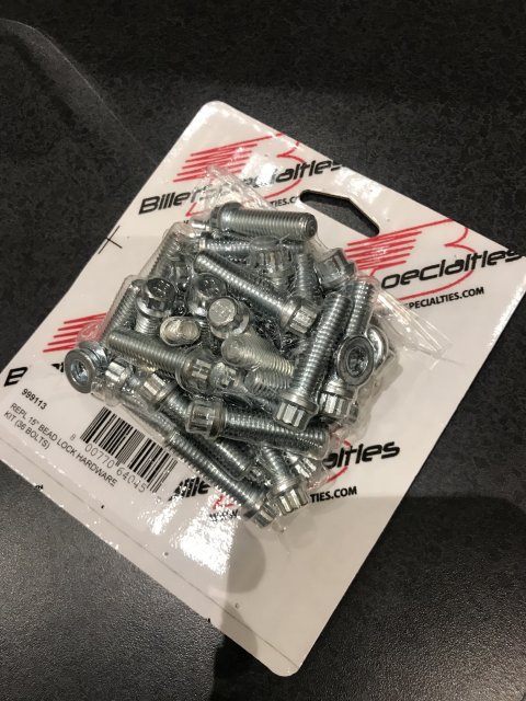

Billet Specialties sells sets of beadlock bolts. High quality made specifically for that application. I have a full set just in case. 6A1A76DE-B238-4D38-A4E4-649419C26F01.jpeg
3,523
8,574
Billet Specialties sells sets of beadlock bolts. High quality made specifically for that application. I have a full set just in case. View attachment 53030
Yeah for D5 its 24 per ring and M8 1.25 x 1.25” :( Forgestars website sucks.

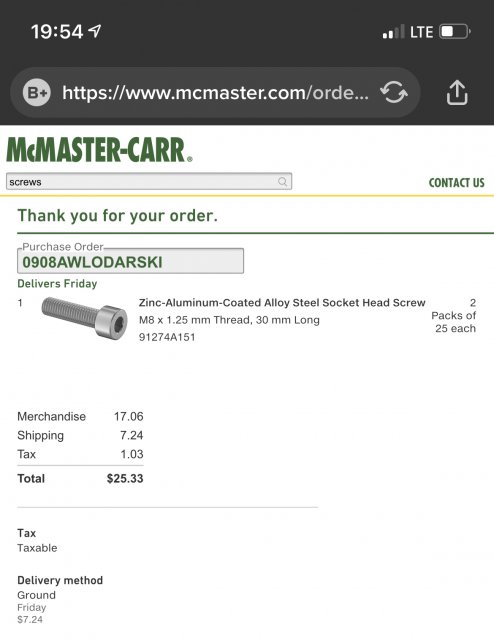

Aw man wish I would have found that site earlier. I threw my amex at McMaster-Carr. I needed M8-1.25 x 30mm with something that had a flange with less than or equal to 14mm. Couldn't find anything close so ordered a non-flanged bolt as the beadlocks come with washers anyway.
https://www.mcmaster.com/91310A536/
However when I added 48 to your site, total came out to 237.00 😐

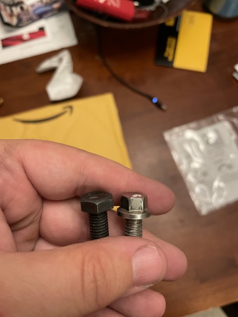

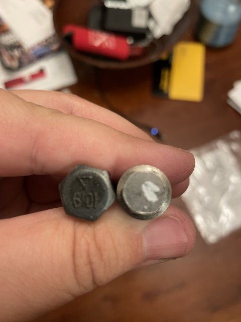

Aluminum? I have a set of D5 beadlocks and I thought the hardware was stainless.??
3,523
8,574
Thread Starter #15
the reason i said aluminum is because i tried hitting it with a magnet and it did nothing. i guess that really depends on the stainless alloy and how much iron is in it.

And of course I forgot I need a socket to fit in the hole as well…
So one trip later to satan… I mean McMaster-Carr… unfortunately they will not get here in time for Friday night… the head on these is 13mm so they will fit just fine. 4DBBCFF0-BB90-484A-B4DD-D8FBD9080EF2.jpeg
