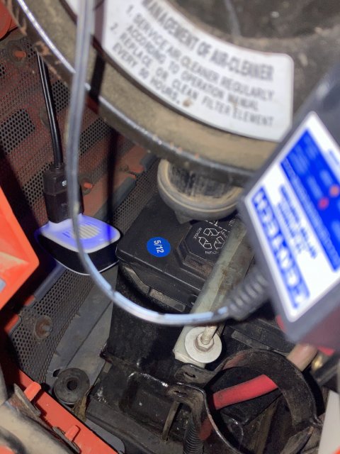

I just started my Bobcat today after sitting all winter with the HF float charger on the cheapest WM battery I could buy in April 2017. Fired right up. Damn that cheap HF crap!!! ;)
