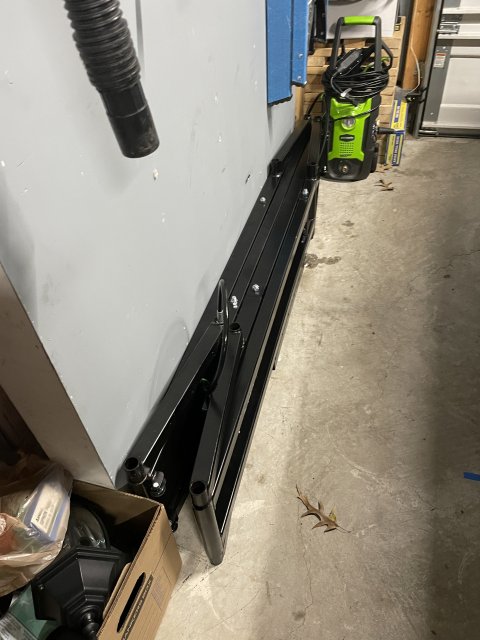

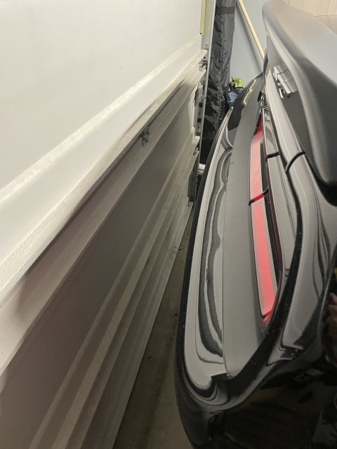

Thread Starter #20

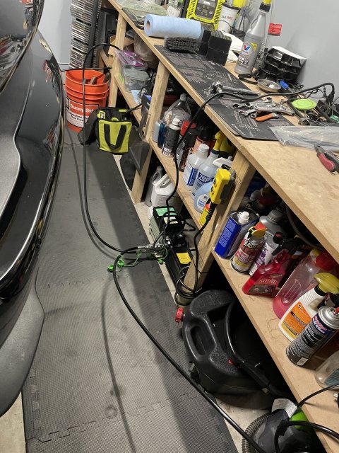

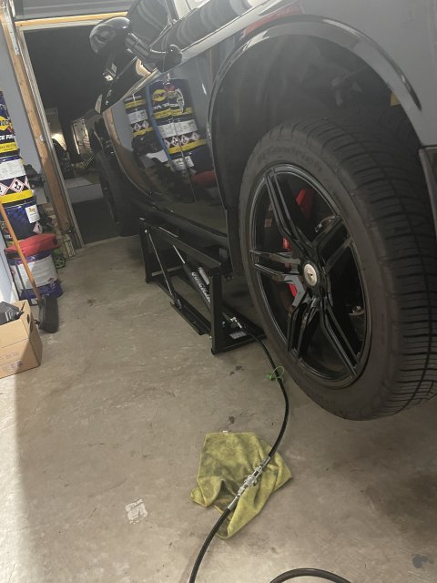

Permanent location of pump and cable route. Also figure out radial shift and storage.
