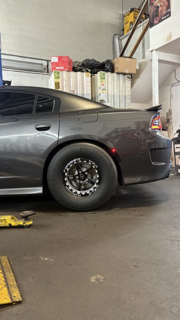

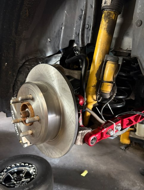

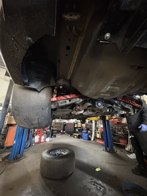

Finally finished the 15" conversion on my 2018 Charger Hellcat
I used the AAD shortened swaybar links and adjustable toe arms to make the process easier. I also used the dusterhoff 15" conversion kit. The only grinding I had to do was remove the old swaybar mounting location by grinding it off clean. The shortened AAD swaybar links mount to the toe arms now. I also used a 3mm spacer because of how close the wheel is to the toe arm.
This car has stock rear springs with BMR drag springs up front.
