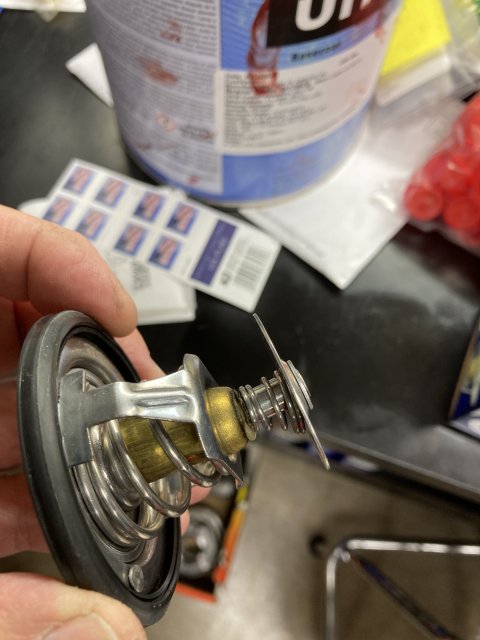

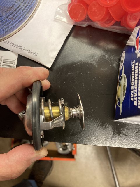

I’ve had 3 Misimoto’s fail, stuck closed, I wont use them any more.
3,313
7,800
Every failed one looked exactly the same, piston blew out and cocked to one side and it’s guts oozed out not letting it open.

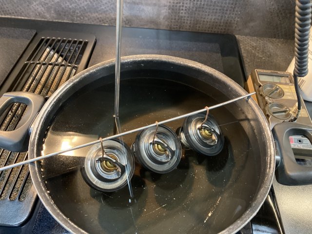

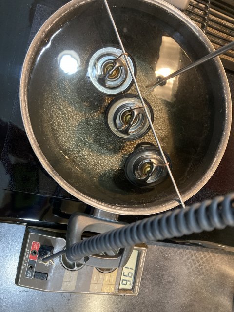

What are you using now?
The one that opened and closed most consistently around 180, purchased from 3 different stores as 3 different brand boxes but all motorads inside each 471AC238-8BD7-4E3B-BF6C-B72AEB41B612.jpeg 7580B40E-85EC-4513-B9B6-B7DAB53E07C8.jpeg 4B04F0AB-403E-472F-A6CA-93D7431A8D92.jpeg box, all around 10$ each. I always test T stats before use, I bring them up to temp very slow and watch which one cracks first, get fully open first, and closes correctly then make a pick and return the others for refund lol.
