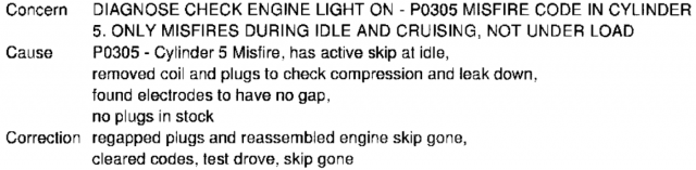

Update
I dropped it off and the tech found both plugs for cylinder 5 to have no gap! I'm hoping this was a manufacturing mistake when the plugs were originally installed. I've never heard of this happening to any other Hellcat forum members. I've put roughly 100 miles on after picking it up and so far it's been running great now.
This is a copy of the dealer work order.
4,679
24,285
Update
No gap. WTF
