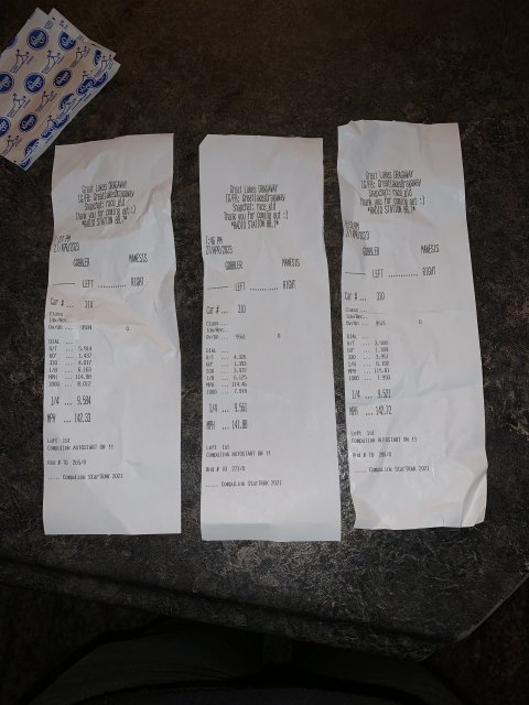

To keep it short
-Built A8 Trans
-Gen 5 stage 2 3.0 Whipple
-Menscer's all the way around with a full AAD control arm set in the rear
-15inch Conversion
Car made 970whp (Still on a stock motor 🙃)
Best ET was a 9.5 @142 with a 1.38 60' on my old setup, haven't run the car on the new setup yet.

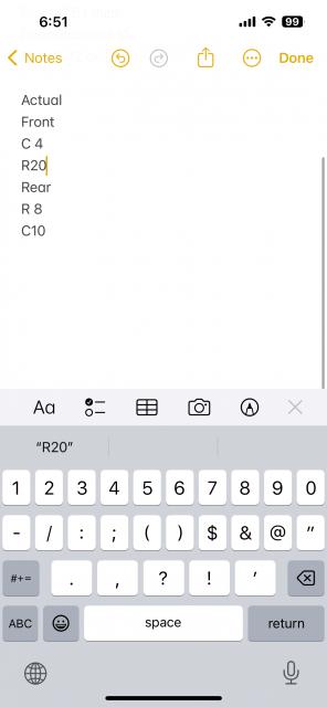

Here is where I landed on some pretty bad prep this weekend if you are still looking for some advise. This was my first time out with them I still have a lot to learn. But this got me down the track when others were struggling. I have a lot more settings to try.
