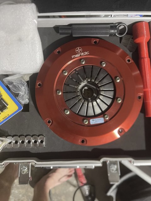

I just picked up this Mantic triple for 2200, with new TOB assy and all. Will be weighing it to compare to stock and RXT1200HD assemblies, I’ll post numbers 24945B65-B4B6-48E9-BAC3-FC27C777454A.jpeg

I just picked up this Mantic triple for 2200, with new TOB assy and all. Will be weighing it to compare to stock and RXT1200HD assemblies, I’ll post numbers View attachment 86294
Nice!

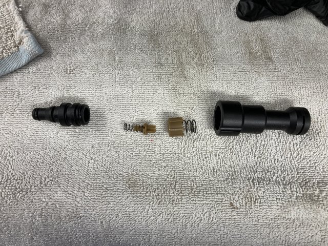

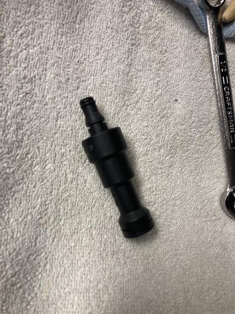

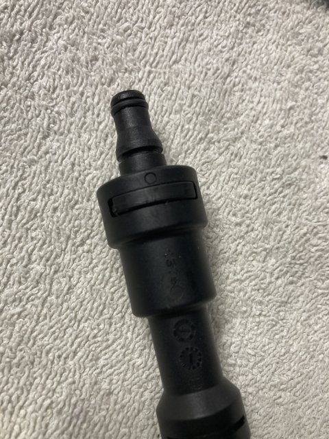

Take the REAL CDV valve out and your chatter on start off issues go away I bet. Just take it out and take the internals out of it and put it back in and see if you see a difference it only takes 1520 minutes to do. You can put the parts back in just as easy too. I just did mine and it is a whole difference starting out with the RXT1200 HD no more chatter and it’s not really picky to get it right anymore.
BA362A96-3A92-444B-A515-B989D2D4A876.jpeg BF15B08B-3023-4FE0-B3E3-3D0061D3CFEF.jpeg 672BF914-0FC2-41B3-A177-BF349C69F53A.jpeg

Yea, want to leave it there then. Lol but I tell you what a difference it makes in how the clutch feels on start off. It feels just like a stock clutch now perfectly easy and smooth. I love it now.
