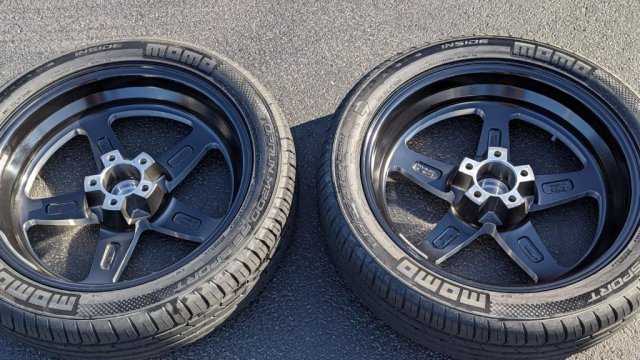

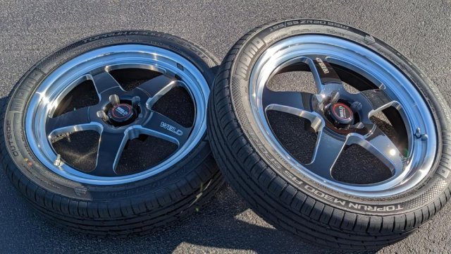

They make skinnies for your years. I have a pair on deck if you are interested with tires.
if you go up in boost 93 will reach its limits quick, might have to splash 104 in to make sure you don’t detonate.
i won the 10.0 class on a 2.72, but it required 104 to keep the motor happy
I thought they didn't make skinnies for the '21 up cars with the bigger brakes?
3,959
9,781
Atleast im not crazy, cuz thats my understanding too
