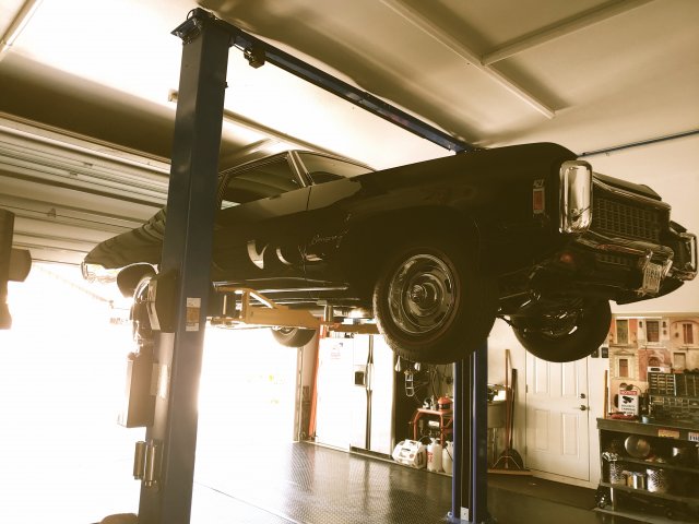

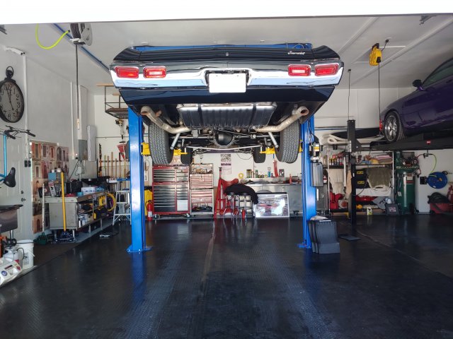

As you can see my four post has the Biscayne on it so a lot more work to make use of it.

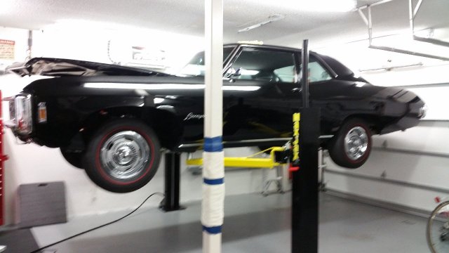

Another option is the MakJak very nice lift for a low celling garage and if you have a stable 4 inch slab it works great. I had one
Since I don't own a Biscayne, that's not a problem for me. The 4-post is always available.
On the other hand, there's usually a Ram 3500 parked "in" the 2-post. But even if that spot was empty, it's so much quicker to drive up on the 4-post and hit the button than it is to get all four pads on the 2-post situated just right, and at the correct height.
Got the 2-post first and thought it'd be all I'd ever want/need, but as mentioned, it's the cheapy 4-post that gets used the most, by far.
Dang - nice! Is that a real 427 Biscayne? '68?
