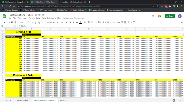

You got the math right, that's the important thing and @white1 filled in the other part.
When I was figuring all this out I built a spreadsheet that I could punch in a desired AFR and it would give me the lambda and PE value I needed to reach it. .0722 + .0147 = .0869. 1 / .0869 = 11.50. .83 x 13.85 = 11.4955
Going with Flex I had to think in lambda.

https://docs.google.com/spreadsheets/d/1uYSQeDEMhGIolAYCdreuVwLCztnnKOr9b0QcKh9t-k0/edit?usp=sharing
The above is my spreadsheet I cooked up while doing my tuning for e85. Please enjoy and make copies and use! The first sheet is just a good general table of values for references to have in mind. As an example I look at my current tune that targets .85 lambda and I say in the new revision I want to target .80, I know where to approximately look. The second sheet allows you to copy in your current PE data - [ECM] 34230 - FA Power Enrich Aircharge Based: Fuel/Air ratio adder for WOT power enrichment based on cylinder aircharge and modify it. Since we have to tune in FAR, Lambda still doesn't work right and imo is still a gimmick, just my .02 so we still have the ugly conversion from AFR to FAR but hey automated. Sheet 3 is just some constant data that I wouldn't recommend messing with.

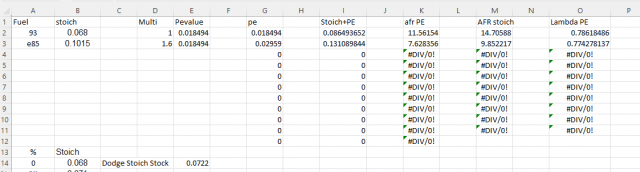

I think you are over thinking the AFR and Lambda. Here is my spread sheet super simple and basic.
You shouldn't have to start with afr to go to lambda. No those are not the values I use in my tune I must have hit save on the last datalog I looked at for someone
But your sheet looks good for a direct copy and paste of the power enrichment table.

One thing to keep in mind if trying to tune in afr and why it gets confusing
Depending on the stoich used afr is changed. So dodge not using .068 really throws the whole AFR calculation off and why lambda of 1 makes more sense or lambda of .85
So in this example .068 with the same values in the power enrichment table as .0722 afr is thrown way off and it takes a different value to command lambda at power enrichment.

Funny, my cheat sheet look just like @jonx96 I just built a function to calculate it all out until I had it sorted in my head.
