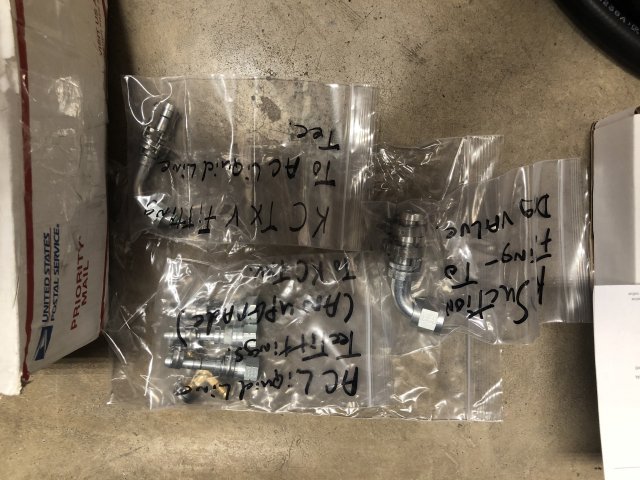

Just opened box for pictures. Gen3 Killer Chiller for Hellcat. Includes Drag option valve, Heat Exchanger 3 way bypass valve, and AN fittings upgrade kit. Latest prices this am on Killer Chiller website
$750 for Hellcat kit
$200 for drag option
$200 for 3 way bypass valve
$150 for AN fittings kit
$1300 total
- $100 coupon (until 1/5 only)
$1200
Your chance to save an additional 20+%
Asking $950 for it all, shipped in cont USA

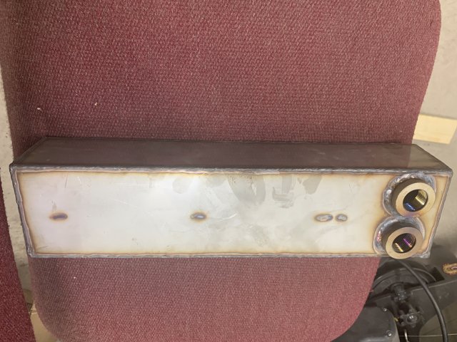

Hopper tank done, ended up making it from 1/8” SS. Will insulate it and install 2 45 degree hose barbs one Tee’ing into the blower coolant supply line the other to the KC unit. Waiting on larger KC to return to open it up and get it done

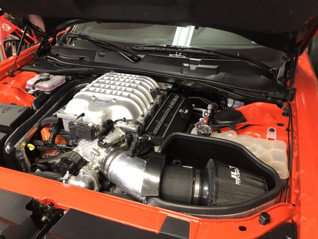

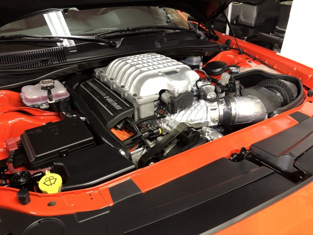

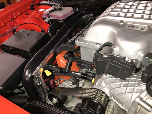

So the drag size KillerChiller is finally fully installed and operational :) 28F coolant in 50F ambient and Kincaid in talking with him about Freon charging said it’ll perform that well even in 75-80 F ambient, that would be SWEET. I Only had a brief ride out with it in a clean break and butt dyno and under wear say different lol parts of the ride actually made me think how close to the edge I get in this car at times reliving the moment afterwards, haunted me afterwards.
Here’s a picture of the engine bay, other then the heavily insulated chilled water lines right to the super charger inlets clean installation. Neither drag valve or 3 way bypass valve can be seen, it’s all down under the air box and head light, factory like. I’ll post up a string of pictures of steps beginning to end soon. 6D6A3174-2A53-41A5-842E-43C41777D04A.jpeg 6E48077A-5966-4812-8F9E-E01DBB81E7BA.jpeg 308022F3-DA9A-4B06-9054-08A1D8120AB0.jpeg
2,696
First class install. Very nice! Good luck, hope this thing works as good as it looks. If it does you prob got them some business from here alone. If they use your car on their site as a poster advertisement for success maybe you can work out a gratis deal.
