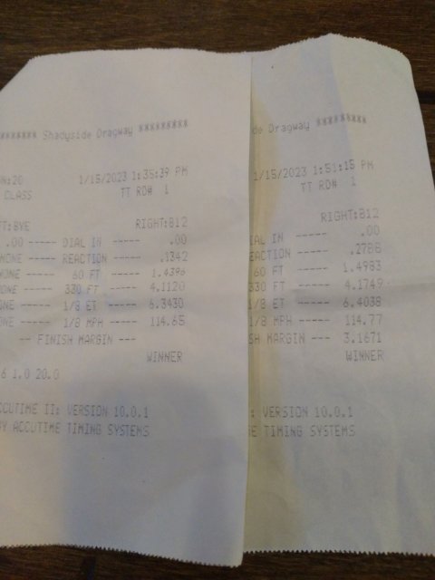

Good News, Got some decent weather so decided to hit the track. DA wasn't the best but ran a 6.34 and hot lapped a 6.40.
Car was flying but the MPH on those is reading a tad high, Dragy showed 112.

That 6,34 probably would've been a 6,299 with my shorter 305 ET Street R;s but these Hoosiers are getting worn and I'm going to burn them off to swap them with a 27" tire and a 'E85 Race" tune instead of Flex.

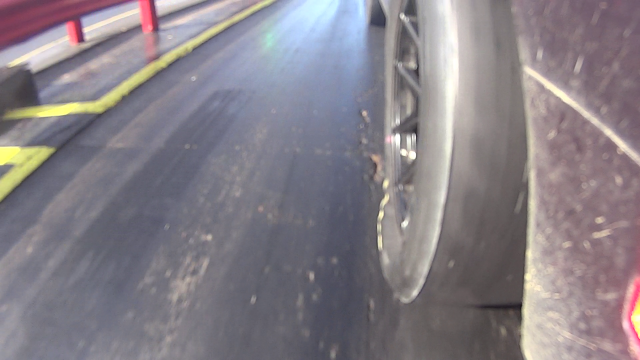

These Hoosier's stick pretty much every time at 22psi, they were wadding up pretty good Sunday. Probably could've used another lb.
I did have a bit a of learning curve with the Street R's with their stiffer sidewall. Found out real quick 22 is too much for them, 19.5 has been the sweet spot.
