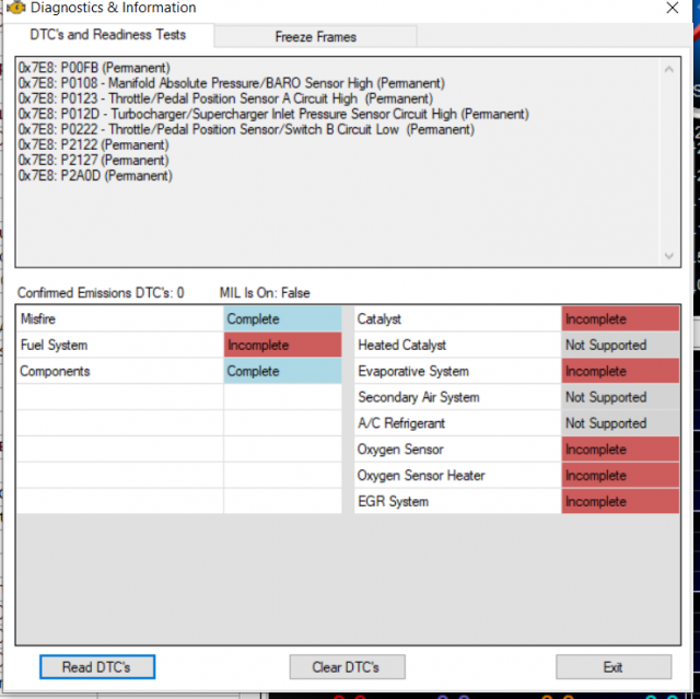

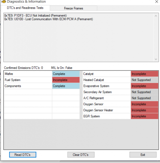

The car idled real bad and I noticed it codes come up
So I pulled codes and they are listed below
Let me make sure everyone knows THIS IS NOT THE TUNERS FAULT!
The car is not recognizing a whole bunch of stuff.
I clear the codes they come right back
Has anyone had this issue going from diablo to HP?
Current issue
Original codes

I just took the pcm out again blew air in both pcm connectors loaded stock tune and now I’m only left with these codes.
I'm guessing when I did the throttle relearn it fixed those codes but not the rest.

Well I found this. I hope it isnt the case.
https://forum.hptuners.com/showthread.php?86658-18-Charger-Scat-P1DF3-Code-Tranny-Stuck-in-Park
"Replacing the TCM solved the issue."
"Running is replacing the TCM/valve body which will run $1,943.60 + tax."
Edit-
I have talked my self out of thinking this is it. Since I do not have the following codes.
U0121 - Lost Communication With Anti-Lock Brake System (ABS) Control Module (Permanent)
U0140 - Lost Communication With Body Control Module (Permanent)

Don’t ask how. On one of the ram forums I found leaving the battery unhooked all day fixed their issue. So I did just that today and the car went into gear and idled fine.
only issue now is just I can’t change traction control modes and the traction warning is up. But maybe just driving it will fix that
