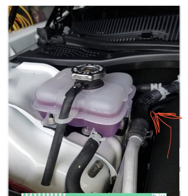

I finished my blower spacers and heat blanket install this past weekend. Here’s a great way to bleed your inter cooler without using the bleeder on the back of the supercharger and making a mess.
do this in this order.
1- pinch the top hose right next to the coolant reservoir (see arrow in the picture).
2- open the reservoir cap
3- cycle the ignition on but dont turn the car on. When the ignition cycles to on, the IC pump will run for a brief period of time.
Pinching that top hose will cause whatever air was introduced into the system to cycle to the reaervoir bottle instead of making its way down to the pump.
look at the IC reservoir when you cycle the ignition on and you’ll be able to see the air bubbles.
after trying that three times, i kept the hose pinched, the reservoir open and started the car. Let it run for a minute so the IC pump would run at its normal rate and bleed out whatever air might have been in the pump or near it.
take the clamp off the hose, close the reservoir and you’re good.
I test drove my car after the install and got on it hard!!!! No check engine light or IC coolant level warning at all.
