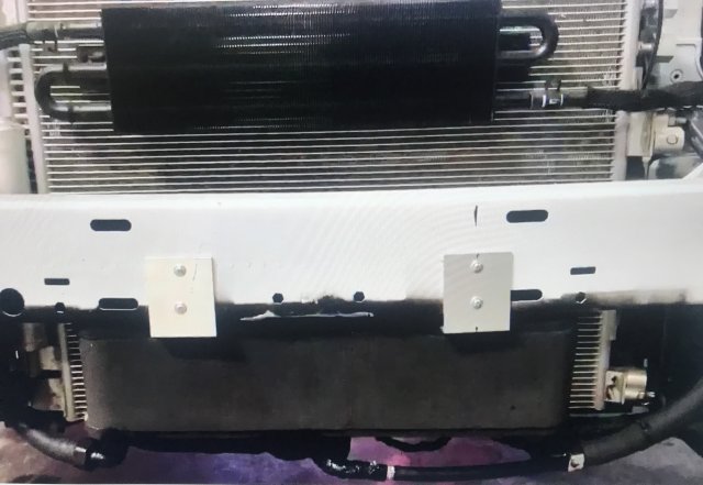

Ummm. I’ll just say this..... I didn’t cut the front bumper crash bar. Simply mounted the brick to the underside using the included brackets. I know... it blocks some of the lower radiator. Makes no difference. Driving the car around in 100++ degree heat in Phoenix with no rise in engine coolant temps. I know what the instructions say. Men never follow instructions. Ask my wife. 69514F96-7EC4-4125-973A-F31BC72A3FEA.jpeg

Ummm. I’ll just say this..... I didn’t cut the front bumper crash bar. Simply mounted the brick to the underside using the included brackets. I know... it blocks some of the lower radiator. Makes no difference. Driving the car around in 100++ degree heat in Phoenix with no rise in engine coolant temps. I know what the instructions say. Men never follow instructions. Ask my wife. View attachment 3939
Nice. This is a reply I can ponder on...
Thank you.

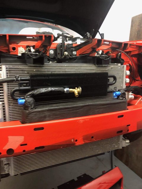

Do you have the stage 1 or 2 kit? The stage 1 kit requires no cutting into the bumper.

FI Interchiller Stage 1 mounted on my car.
