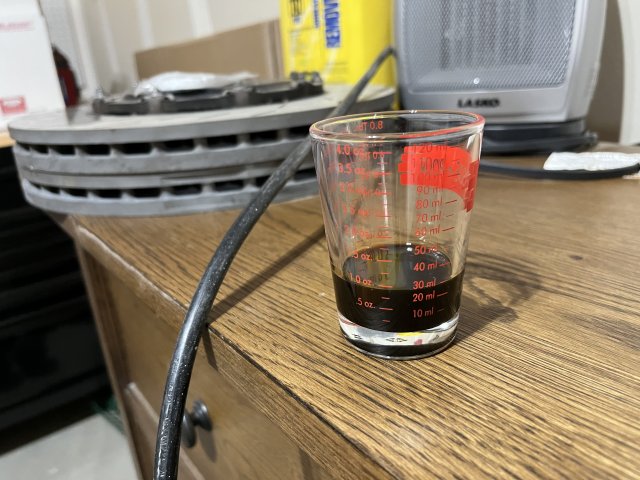

I’ve never had another car with a catch can, so I’m a little unfamiliar.
Pulled about 30ml out of my car today which probably had about 2k miles since I emptied it last 5 months ago or so.
Kind of surprised to see this much but I have zero frame of reference.
I have a 3.0 oz JLT catch can and on 3 different vehicles I have seen about that much oil at roughly the same mileage. I'd say that you're in the "normal" range.
Well......not you.......definitely not you......
But oil qty in the can wise......normal range.

Mine barely had a drop in it everytime I checked it.

What brand catch can? Some work better than others and catch every drop, like UPR units.
3,635
8,549
1 oz, 2k miles, your fine, not abnormal at all, especially if you run it hard which most M6 guys do 👍
