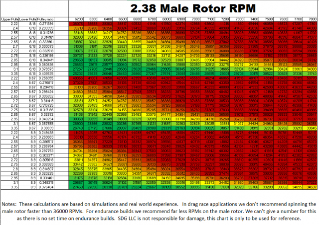

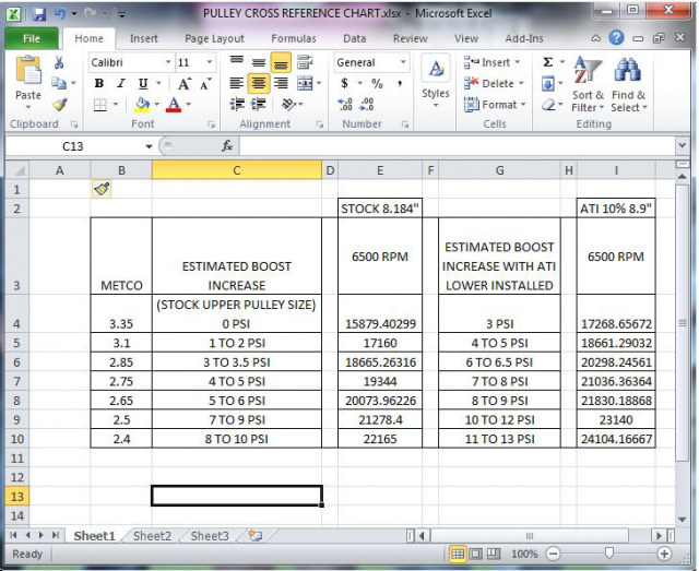

8.9/2.69 x6400rpm=21,174. Stock with 3.35 upper ~ 15,600 at 6400 rpm engine speed. Pushing the limit imho.
58,226
200,248
SDG has a graph it is on the site for rpm
