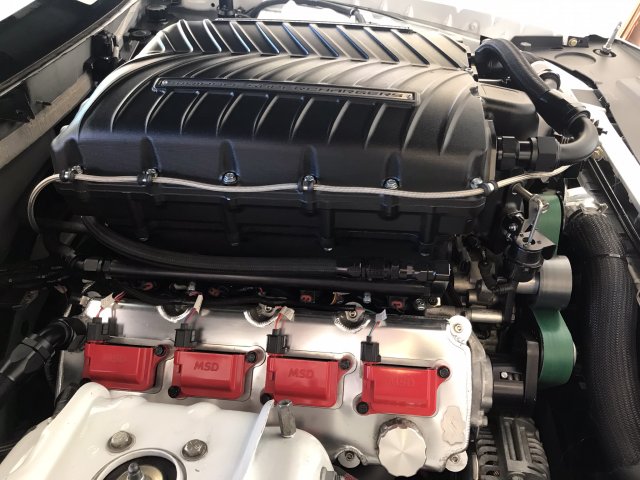

Everybody I’ve talked to has said that there is no reason to replace good stock coils with anything else. I sold mine with a set of valve covers because I wanted to go with the big fat Holley EFI “Smart” coils. They have tuning capabilities that regular coils don’t have, so I was thinking that would come in handy way off in the real fast future. They turned out to be 100%… unreliable. Went through two sets (pretty much wasted my time in Houston last year) and sent them back to Holley. So then… I didn’t have any coils and had to buy some. The MSD’s weren’t any more expensive than the factory stuff. They had proven to be reliable on other cars and most importantly…. They were RED. FB2512F2-E551-4A31-B329-0E6D2CAEEC99.jpeg
