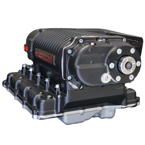

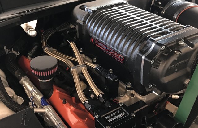

I truly hope you didn't frag your SC. However if so, don't even bother rebuilding that IHI junk. Make the jump and get a hardcore SC you'll never need to worry about again.
