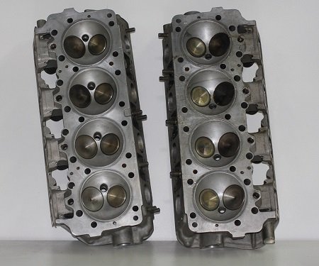

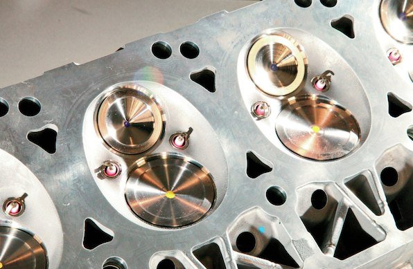

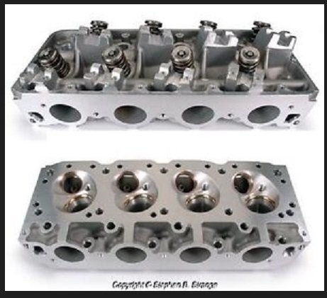

Somebody post up pictures of the two combustion chambers and it will be immediately obvious.

Agreed, modern "HEMI" motors aren't even hemi-spherical at all!
Gen 3 is sort of a squashed hemisphere. Interesting that the Ford Boss 429 was similar. All had splayed pushrods and canted valves.
Gen II
Gen III
