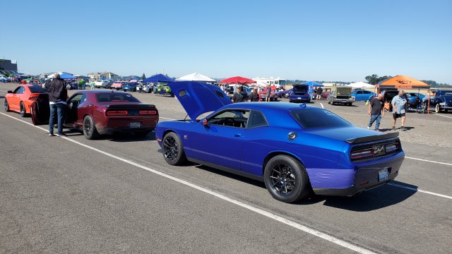

Any pics of your car?

This was last year at the Mopar Nationals in Woodburn Oregon. Made it to quarter finals in Modern Mopar category. This was before I got the skinnies in the front. No more tape either. The MT drag radials don't spit much rubber off them which is great. 20200719_101334.jpg
