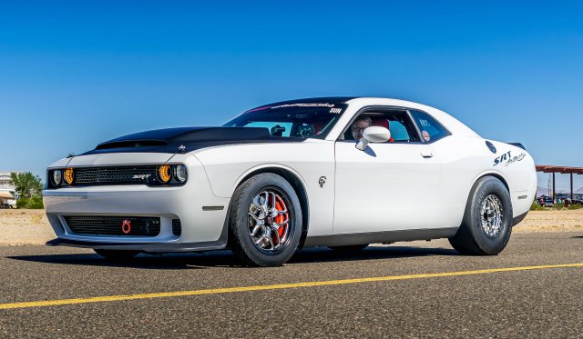

Went out to a track rental a week or so ago. Ran quite a few passes. Hot lapping the car pretty decent as well. I made around 15 passes.
I came to the track and just unloaded it the way I raced it in Ocala. Which is basically a street tune on the 4.5” pulley with a couple tweaks from Mario at Gearhead during the race. Car went 174mph in half on tune.
Ran consistent 9.6-9.7 with a best of 9.62 at 146 mph with a 1.55 60’
I cannot get the car to hook when I hole shot it.
I foot brake it and stalled to 1300 rpm, pause and wait for the last yellow and put it to the floor and spin.
I managed to baby the throttle and get a best of 1.49 but could not get further. When I gave the extra ass kick it won’t stick.
The prep seemed alright. A murdered out demon went 9.12 at 156 mph with a 1.26 60’ carrying the front wheels for like 70’. It was sick AF.
Anyways. The launch is a pain and not sure what’s up. My suspension mods are as follows.
Dss lvl 5 half shafts
2.62 Diff
Tba machine diff brace
Bwoody upper control arms
BMR Cradle lock out kit
Mopar lowering springs
Wheel is a bogart 17x10.5 with a 315/50/17
Tire pressure was 17.5 psi in rears, and I heated them up.

I don’t think lowering springs are helping your situation any. I went with the Mopar 1320 Scatpack Drag Springs. They come with light weight front and rear sway bars. They do not raise the front or rear of the car like the Demon or other weight transfer springs do and they ride nice. Softer than the Hellcat springs which is a good thing after all the bushings and control arms tighten everything up. As far as the Whipple thing goes.... ask ZHC about what it takes to get his 427 Whipple down the track. Track tuning! Obviously he knows what he’s doing and because he’s tuning his own car, he can invest as much time as it takes to figure it out. I took mine out for it’s maiden voyage down the quarter mile and made one pass. DA was 3000’. Decided to start with the tires at 20 lbs. That was my first mistake and I learned something about the Radial Pros (they need to be a lot lower than that). This was a initial test pass with zero track tuning to get some data. 4.0 pulley with 3.25 gear was going to be a challenge and with the tires at 20 lbs....it hooked up at half track when the tcm said screw this and short shifted into 6th gear. It ran 9.61 at 147 mph with a 1.57 sixty ft. So that’s the starting point and the challenge is the same as yours...... put it to the ground. Because I don’t drive the car out on the highway.... my decision on how to do that is easy. I am not going to spend countless passes down the track, logging data and swapping files to get a handle on the tcm. I’m not going to burn up (or break) a hp90 or two in the process. The T400 is ordered and that thing will put the power to the ground and shift when I tell it to.

WhipCat, if your control arms are not adjustable I would get some that are so you can make sure your tires are getting full contact.
There was a guy with a scat pack Challenger that said his car hooked way better and on the street and track after he installed some Spohn adjustable control arms. Said it was night and day difference

Also.... in case you (or anyone else) is wondering how it sits on those 1320 springs.... and that’s on a 31” tall tire 754B2C72-A2F1-49E8-BC30-BE644CA493C2.jpeg

They are fixed. I was thinking of doing the adjustables as well, put it on alignment rack, put some weight in the trunk and get the rear to squat, then do the adjustment perfectly.

Whip! You have to adjust your camber. These things come with negative camber and when you lower it.... you increase that. When it squats, it goes further negative. You are only getting half your tire on the track. I was back on the alignment rack just yesterday because of all the changes to the suspension and rear end that have been done. We had to change the toe links to fit the 15” wheel conversion and I just had a guess in there. That was probably another issue for that first pass down the track. It was pidgin toed in the rear. A full degree in. I did a burn out on the street and it left two outside edge stripes because of that. That’s not the way to get down the track. At this level you have to address everything.
I need to come over and get the alignment done at @Marc0779 placs.
I remember back him telling me about this.
It’s fun racing, but I want to pull the front tires and launch this thing.

On a side note I have Demon springs and swaybars front and rear . They definitely helped with the launch and smoother on the street . I'm not making a million hp like you guys but I'm impressed with the upgrade .

Aad upper adjustables Spoone lower adjustables head down to Marco i will set you up
